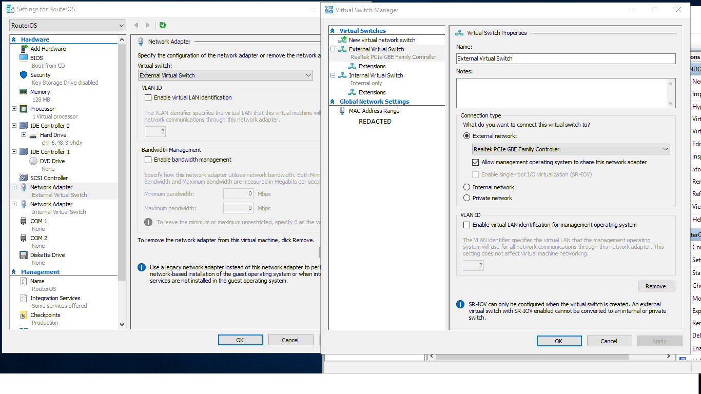

Yes, I am using Hyper-V and choose the “external network” and I see “vEthernet (new virtual switch)” adapter next to my NIC addapter.
So if there is just a single physical network interface on the Windows
Yes, only one NIC card.
Regarding the 3 options you suggest:
I created a virtual switch as described above but have no Internet connectivity on the CHR, which makes sense as there is no DHCP server running on neither Windows Host nor the virtual switch.
If understood it correctly, I should either create a private or internal network (which of the two?) on that virtual switch, run a DHCP server on the CHR or the virtual switch (I do not know how to do the latter) and then Bridge on the Windows machine, the physical NIC adapter with the virtual switch? Is this correct?
Does the fact I have a second static external address, from the provider, help anywhere in the process? It is a X.X.X.X/32 IP linked with that server, but is on a different subnet from the 1st static .

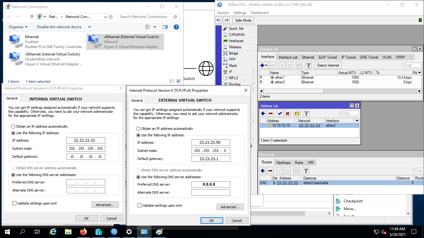

A private network on the virtual switch is accessible to the virtual machines alone, not to the host, so it is useless for connection of the CHR to the internet.
If you create an internal network, a corresponding virtual interface is created in the host Windows, which you can use to share internet with the CHR connected to the corresponding virtual network.
If you create an external network for the only physical adapter available, the bridge is created in Windows as you’ve already noticed; if you deassign the non-/32 public IP on Windows and assign it to the CHR interface attached to that external network, the CHR will have internet access (of course don’t forget about mask, default route etc.). And you can use the internal network to let Windows access the internet via the CHR. It depends on you whether you configure the IPs statically or set up a DHCP server at the CHR, but static configuration seems simpler to me.
If the second public IP is routed via the first one, you can’t use it for the CHR if the basic one is assigned to Windows, but you can use it for Windows if the basic one is assigned to CHR.
If you keep the Windows on a private address, the CHR must act as a NAT for it; if you want to assign the second public IP to the Windows directly, the CHR must not act as a NAT.
To have the second public IP directly to Windows, use any non-conflicting private ip, let’s say 10.10.10.10 for the purpose of the example; the /32 public one will be 22.22.22.22.
On the CHR, assuming that ether2 is connected to the internal network, you’ll set the following:
/ip address add address=10.10.10.10/32 network=22.22.22.22 interface=ether2
On the Windows, you set the following IP configuration on the virtual Ethernet connected to the internal network:
IP address: 22.22.22.22
Subnet mask: 255.255.255.255
Default gateway: 10.10.10.10
It will ask you whether you really want to set up a default gateway outside the subnet of the own address, you confirm that. That’s it.
Just disconnect the machine from the internet before you start doing this, and don’t connect it back before setting up firewall rules on the CHR.
I think I understand what you 're saying here, the Internal network in this case will be set to receive an IP address automatically ? Or set it up as :
I was under the impression that Windows do not allow setting a gateway outside the subnet, but can be wrong… In this last example do I need to bridge the Internal network with the physical network or not since it will have the public /32 address ? What about Ether1, where will it be connected?
It feels I am getting there with the above input! Thank you Sindy!

Based on the attached what am I missing ? Haven’t manage to ping 8.8.8.8 from MT
You wrote before that the additional IP address was routed via the first one; the slideshow suggests that it is in its own subnet, as it has a /24 mask.
So the first thing necessary is to find out how it is actually done, because the setup will differ accordingly.
- if the provider routes the 22.22.22.22 to you via the 23.23.23.90, it means that they determine your MAC address by sending an ARP request “who has 23.23.23.90”, and then send to that MAC address a packet with destination IP address 22.22.22.22.
- if the 22.22.22.22 has an own subnet, or if they do it in some weird way similar to the one I’ve suggested for the interconnection of the Windows and the CHR via the internal virtual switch, they send ARP requests “who has 22.22.22.22”.

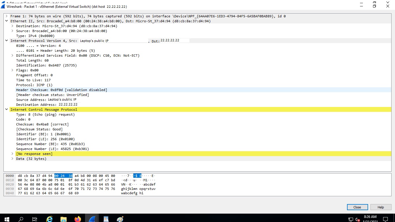

So you need to find out whether you ever receive ARP requests asking for 22.22.22.22 or not. To do that, configure some other address than 22.22.22.22 on the internal interface, wait about 10 minutes to let any eventual ARP records at the provider side to time out, run Wireshark with capture filter arp or dst host 22.22.22.22 on the Realtek or on the virtual Ethernet connected to external, and ping 22.22.22.22 from the internet (or try to connect to http:22.22.22.22 using a web browser, so that a mobile phone was enough). As the 22.22.22.22 is not attached to the external interface of the Windows, either you will see IP packets coming to 22.22.22.22, or you will see ARP requests for 22.22.22.22, with no responses in either case. IP packets mean that the traffic to 22.22.22.22 is routed via 23.23.23.90, ARP packets mean it is not.
I don’t know your environment - you haven’t mentioned that it is a server in some datacenter. If you have no other access to the Windows machine than remotely via this interface, then definitely this is not the way to go, as you’d indeed lose the access. If you can set things up locally, while connected using a keyboard and a monitor, you will have RDP access via the CHR later on. But this is only relevant if they indeed route 22.22.22.22 to you via 23.23.23.90; if they send ARP requests for 22.22.22.22, the whole exercise is useless and you can have 23.23.23.90 on the Windows and 22.22.22.22 on the CHR while both are bridged with the Realtek NIC (external virtual switch).
Of course you cannot ping 8.8.8.8 from the CHR, as both the public IPs are attached to the Windows (and there is no default route on the CHR, only the route to 22.22.22.22).

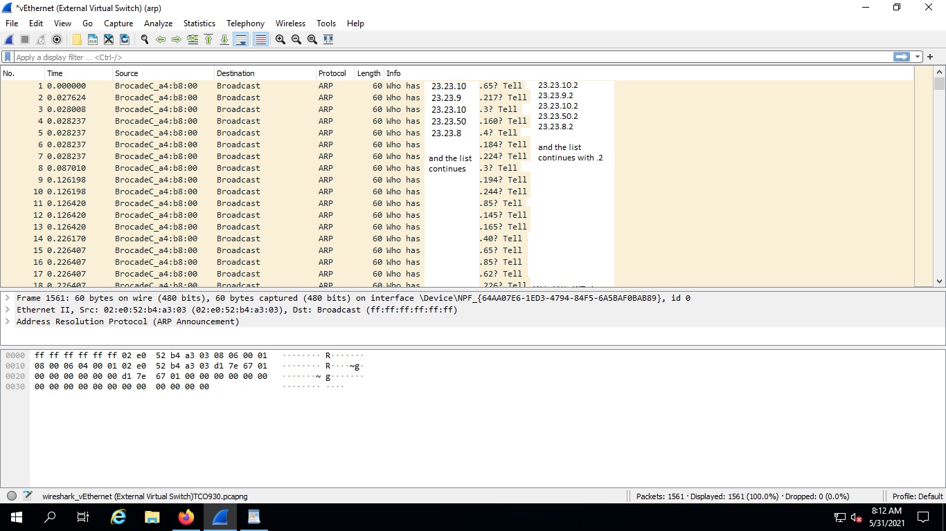

I am attaching both results with ARP filter on External virtual card and Dst host to 22.22.22.22 (ping from laptop) . Didn’t see any ARP requests for 22.22.22.22 when I run ping to it.
Thought I mentioned in the beginning that it is a remote dedicated server (sorry if I didn’t mention that I only have remote access through RDC and no other ways to connect)

This is irrelevant as the ISP doesn’t send ARP requests for 22.22.22.22. If they did, it would just mean to connect ether1 of CHR to the external virtual switch, keep the Windows be connected to it too, and at the CHR, set
add interface=ether1 address=22.22.22.22/32 network=ip.of.the.gateway.used.by.Windows
Thank you Sindy ! All this is very interesting
use a display filter arp.dst.proto_ipv4 == 22.22.22.22. If the packet list becomes empty once you apply this display filter, it’s definitely the worst case.
Yes, it did come back as empty
and after some back and forth with the provider they came back with this:
Dear Customer,
The additional IPs which we provided are forwarded through the main IP addresses which means that they need to be assigned to the server network settings.
Also, the additional IPs do not have their own gateway and MAC addresses.
arp.dst.proto_ipv4 == 22.22.22.22 , to see if I understand it correctly shows ARP requests to 22.22.22.22, if the list gets populated “Who has…Tell…” it shows that the provider sends requests to this public IP (when trying to access via ping) regardless of whether it is configured in Windows (Ethernet/properties/advanced). If nothing comes back it shows this IP is not “active” as it is routed through the first one , and because is not (in my case) configured in Windows there is no response . Am I correct in this ?

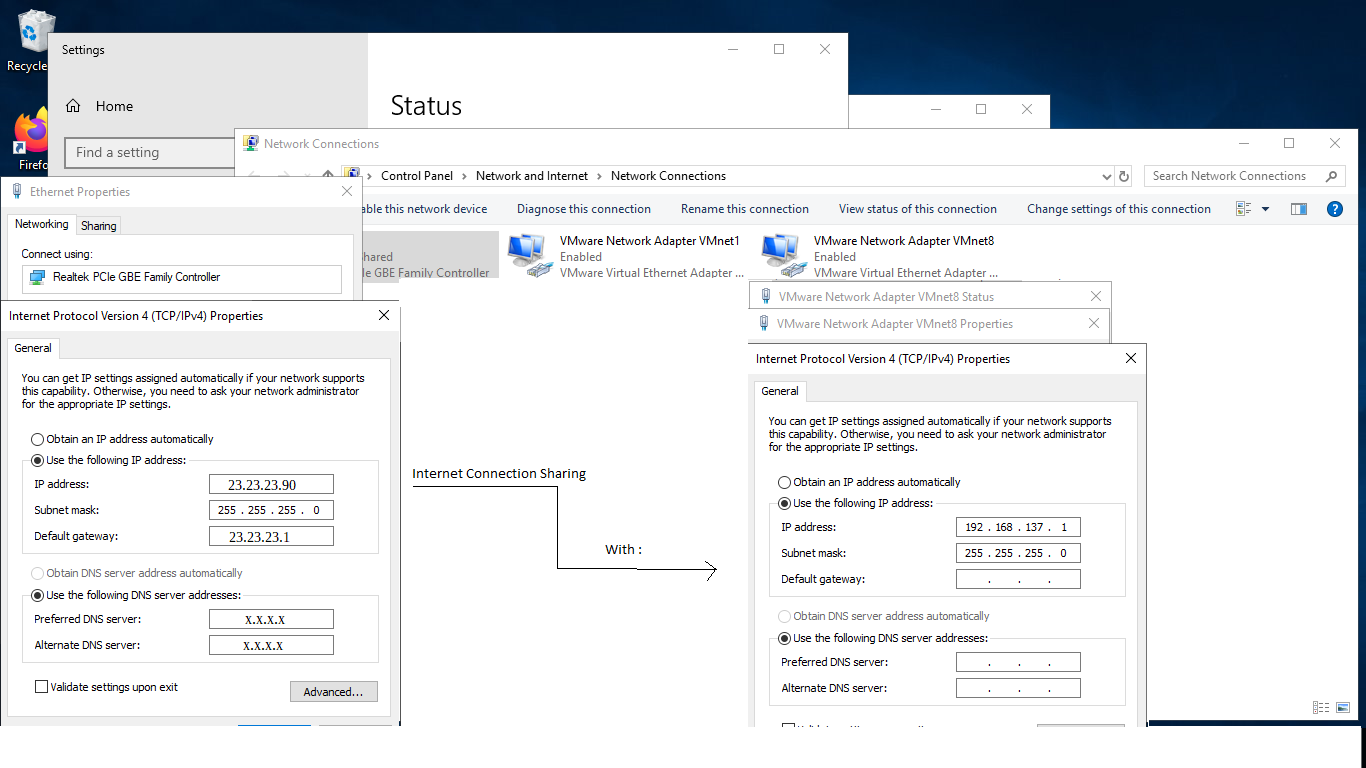

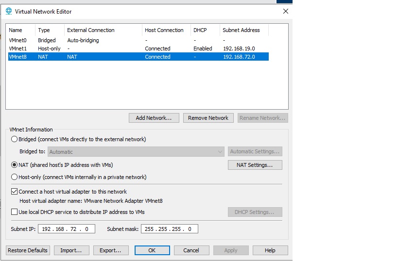

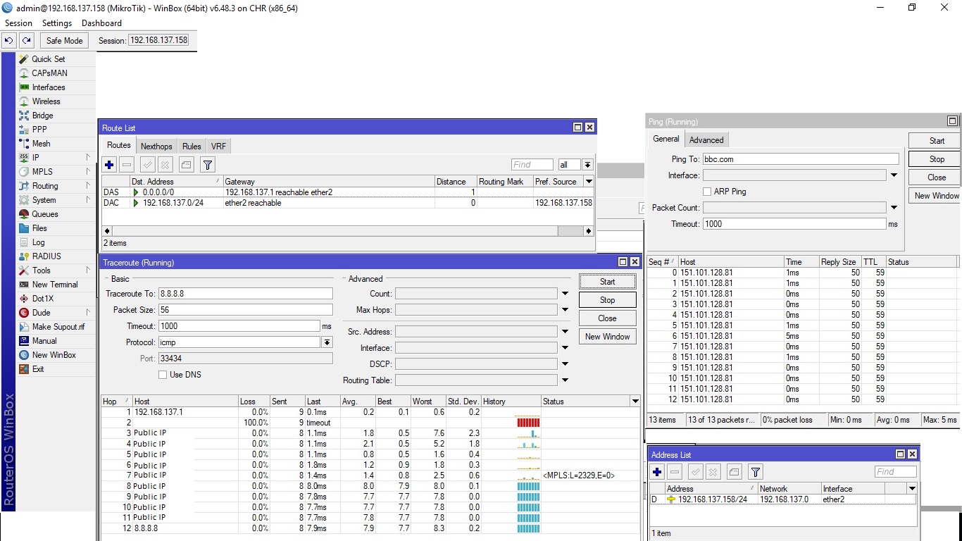

I installed Vmware (attached) and configured ICS to virtual ethernet 8 and I was able to ping 8.8.8.8 and perform a traceroute with a 100% loss on hop 2 (can you please tell me what that means?) I would expect public gateway 23.23.23.1 to be there (in that second hop) or for 23.23.23.90 to be there, however it shows on the third 23.23.23.1 (have Xed it out)… I didn’t configure a masquerade rule as Windows does NAT (like you said in your previous post).
Windows firewall allows to open ports and vmware allows (attached) port forwarding to local addresses , does this change things?
