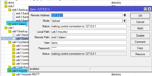

Sounds like a good solution - but I'm too stupid to make it run... probably just a small hint is missing:
SMB-Share: OK
  • /System/disks -> SMB-Client points to a share on my NAS: smb1 | smb-address: 192.168.10.24 | smb-share: "Data_Server/Mikrotik" | user + PW: ok
  • Status: working, as my nighly backup is created directly on the share successfully
rsync: >>> NOK - doesn't work. <<<
  • mode: Upload | local path: "usb1/mounts/" | Remote path: "Data_Server/Mikrotik/daten/" (tried "smb1/daten" as well) | user + PW: should be ok (same as SMB-Client above, right?)
  • I tried: remote-address: 192.168.10.24 -> error "cannot create remote connection"
  • I tried: remote-address: smb://192.168.10.24 -> never ending "resolving dns names"
Why is the pure IP address failing? And why the smb:// is never ending?
Remote path wrong?
Is there any Firewall rule needed (TCP/8291? UDP/500?)?
Maybe the MT docs would deserve some more examples incl. one for SMB...
What is the trick?
Thank you!

  1. create user ‘rsync’
  2. add rsync job
  • mode upload
  • remote address 127.0.0.1
  • local path usb1/<your source folder>
  • remote path usb1/<your smb mount>
  • user rsync

Tried it...
  • rsync-user with "full"
  • first "making control connection to 127.0.0.1".. after a while "failed"
    grafik
