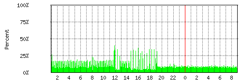

I also recently enabled RPKI verification on my BGP routes and am also noticing regular spikes of 70%+ cpu usage on the router, where it can sometimes become unresponsive (SNMP & winbox).
Disabling RPKI verification (or restricting it to a small handful of BGP sessions) brings the CPU usage down to a reasonable amount.
See the attached CPU graph, where I limited RPKI verification to only one session at 19:30.
