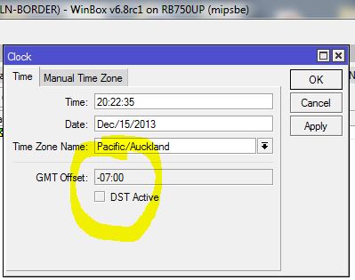

Hi Alexander,
I popped that release on a CRS and it looks like Pacific/Auckland time now says GMT-7 instead of GMT + 13 :slight_smile:

@scampbell
Good of Mikrotik to “fix” our timezone along with all the others.
I can confirm the time in Auckland now is 7:11 pm yesterday (I should look at getting ready for bed soon)
Not sure how Mikrotik stores and updates TZData however it looks like someone accidentially blasted a bad database into it.
Regards
Alexander
6.8rc next release will fix the timezones. there was a bug where all timezones got shifted
