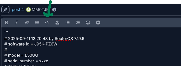

@MM0TJR
Pleease use code tags instead of direct "< pre >" ones.
There are a lot of usefull buttons in the edit window.
