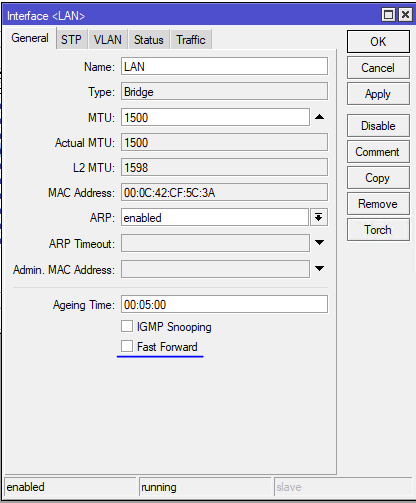

Go to the bridge and try untick fast forward.

Fast Forward depends on many other setting to be active. See the manual.
https://wiki.mikrotik.com/wiki/Manual:Interface/Bridge#Fast_Forward
