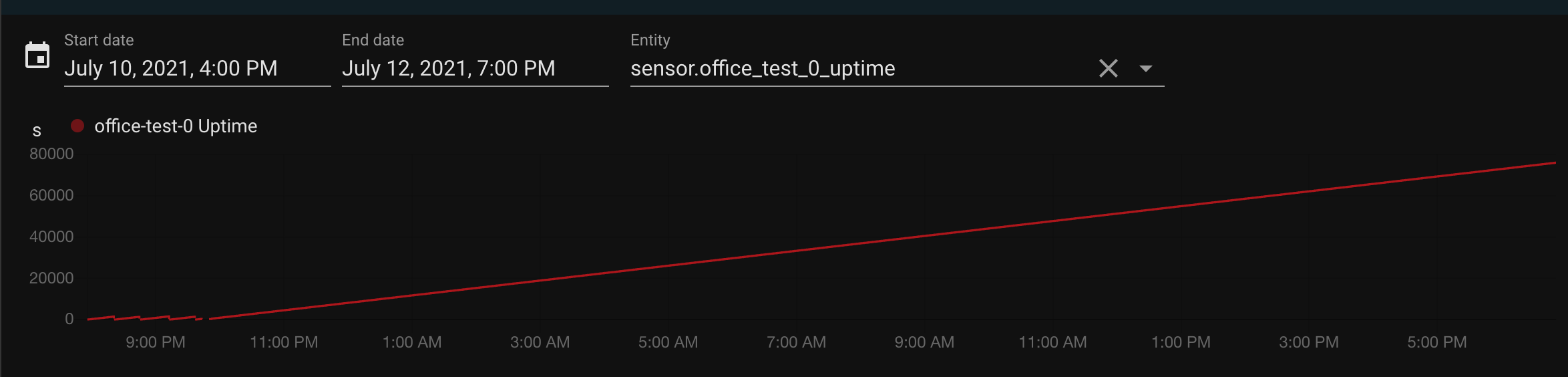

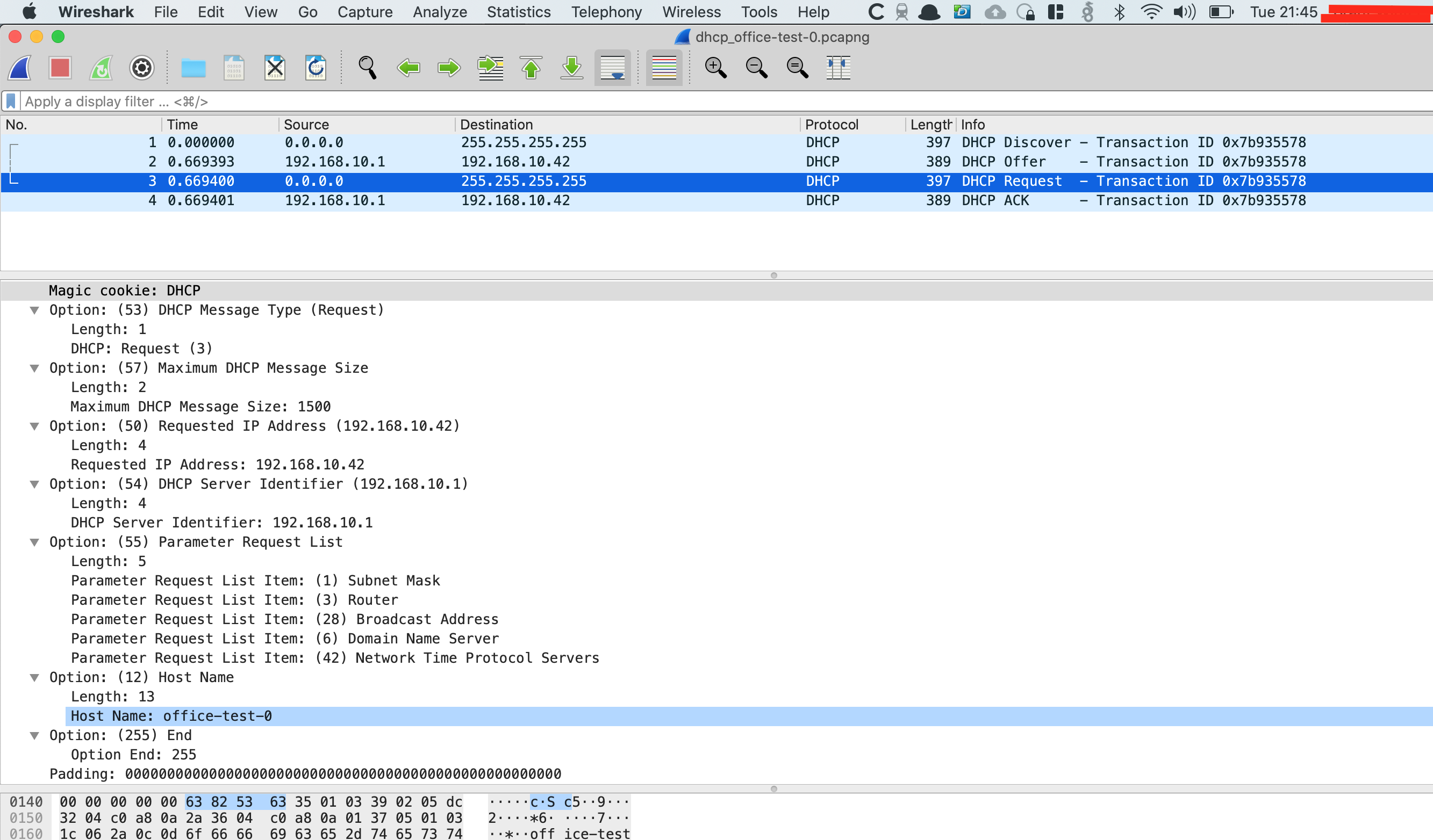

I have a network of ESP8266 / ESP32 devices on a Chateau LTE device. I was using this device to test with before buying ceiling mount cAP devices. I have noticed a few issues with the DHCP server that others in the ESPHome / Homeassistant (home automation) community are not experiencing.

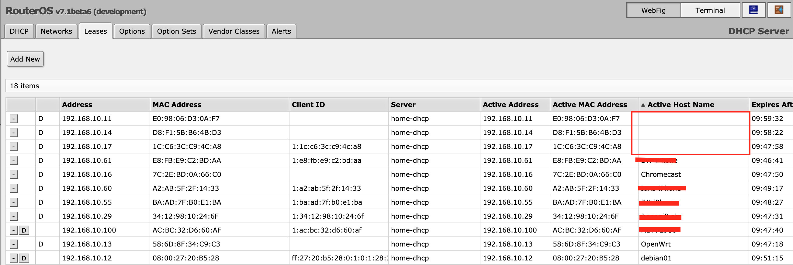

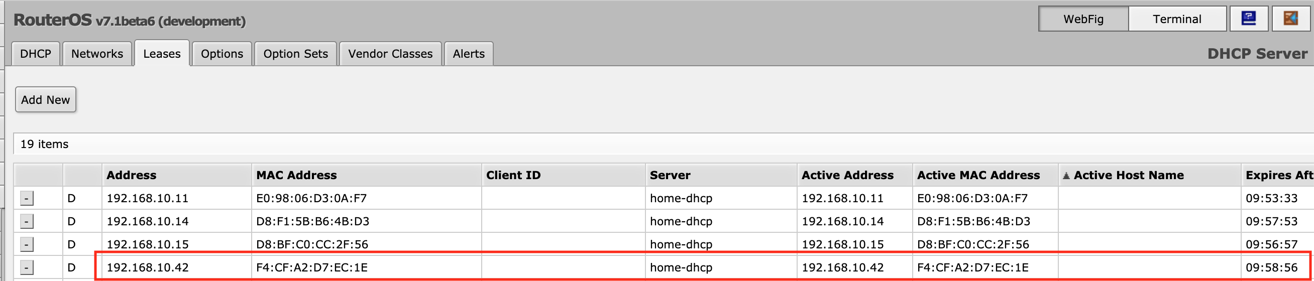

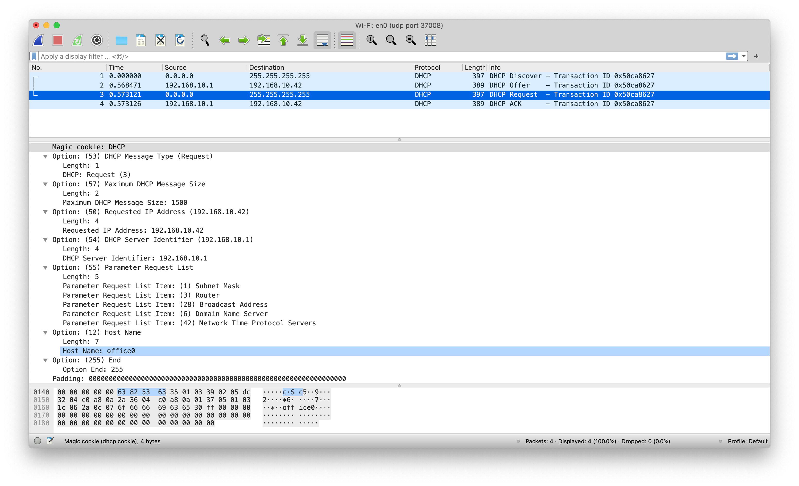

  1. DHCP client hostname does not appear in the initial DHCP assignment therefore my DHCP to DNS scripts don’t work.

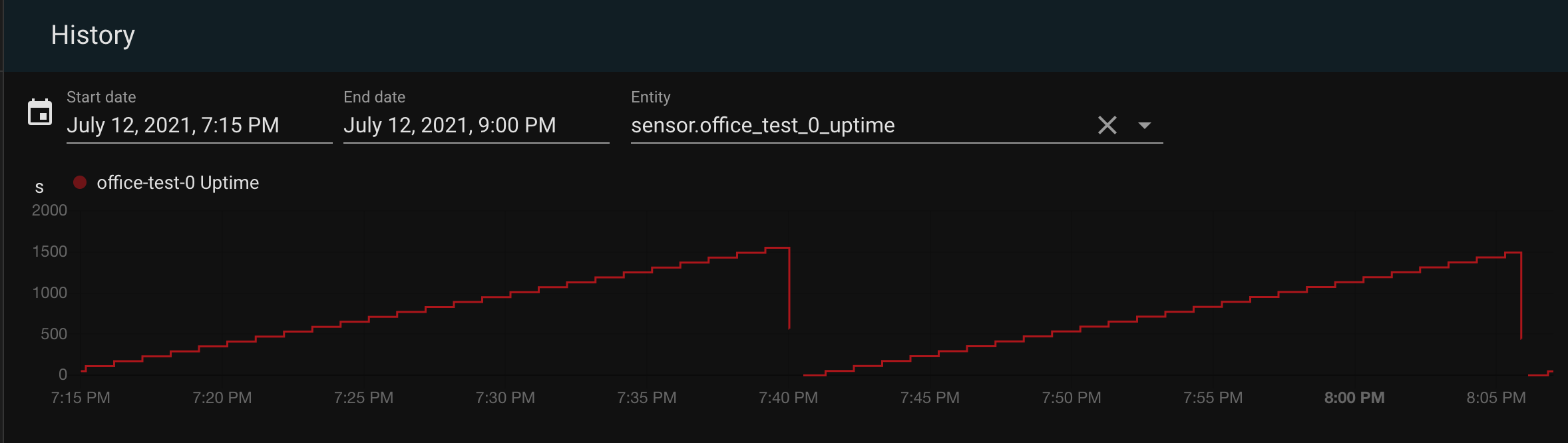

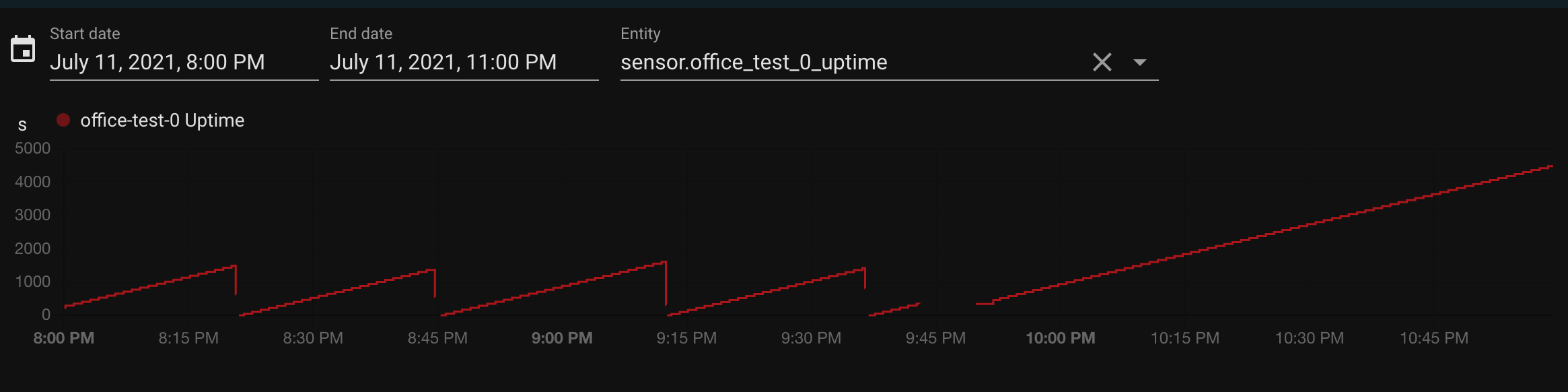

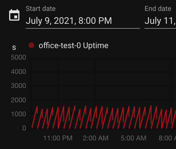

  2. ESP devices crash / reboot when configured for DHCP (wireless) via the Mikrotik device. The devices constantly crash / reboot every 25mins.
I revived an old Billion 7800 router and configured wireless etc. Devices client name appear in DHCP list straight away and no crashes / reboots on any ESP device after 25mins. From this I can only conclude that the issue is with the Mikrotik / routerOS device rather that the ESP devices.
I have no idea how to start troubleshooting. Is it wireless / DHCP config, routerOS bug or user error with config? Cleaning up config export now and will post.

The is the uptime graph from the other day:
The last set on this uptime graph is after changing from the Miktrotik Chateau router to the Billion router:
A very strange conclusion.

Reinstated the Mikrotik Chateau LTE and set DHCP lease time to 10hr. Straight away I can see that the ESP devices have no host name in the DHCP table (red box):
I have now waited 50mins and right on queue the device reboots at 25mins intervals:

So this ESP8266 is running ESPHome, a home automation firmware that integrates with HomeAssistant. I performed an erase and uploaded Tasmota (a competing home automation firmware) and on the Mikrotik Chateau LTE it again fails to register in the DHCP table with a hostname.
Packet trace shows that the DHCP request packet does include the hostname that is NOT appearing in the DHCP table in the Mikrotik router. Not sure what else I can provide to troubleshoot.
dhcp_office-test-0.pcap.zip (548 Bytes)
Changed device name to remove hyphens in case that was causing issues but same story, host name does not appear in DHCP table.

I already have wireshark captures and think I know what’s happening. The ESP8266 is not sending an ‘option 12 hostname’ field in the DHCP DISCOVER packet. It only sends the hostname in the DHCP REQUEST packet. It seems some routers will accept the hostname if it’s present in only the REQUEST packet, my Ubiquiti EdgeRouter doesn’t care, but RouterOS wants the hostname in both the DISCOVER and REQUEST packets. If routerOS only gets the hostname in the REQUEST packet it ignores it.
RFC3397 - https://tools.ietf.org/search/rfc3397- doesn’t mandate which behavior is correct.
I ran into this problem a few months ago, and at the time I thought it was my AP’s fault
Would it be possible to change this with a script on the router?
Either change the behaviour to only require a hostname in the request packet, or change the discover packet to include the hostname before it is evaluated?
