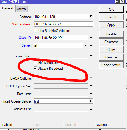

For me the problem is with static addresses and seems to be connected with this option which sends offer even if there is no demand for it.
Converting dynamic address to static makes this option somehow “checked” even DHCP server has it “unchecked” so if you forgot to uncheck then static reservation broadcasts it.
Testing on RB2011 with 6.42.11
I’m having this issue with one device in my network. Are you suggesting to check or uncheck it?
Uncheck …
“Always send replies as broadcasts even if destination IP is known. Will add additional load on L2 network.”
DHCP broadcast an offer even if device is just deassigned.
Does not help … no change .. still receiving warnings
Same for me, issue still remains.
