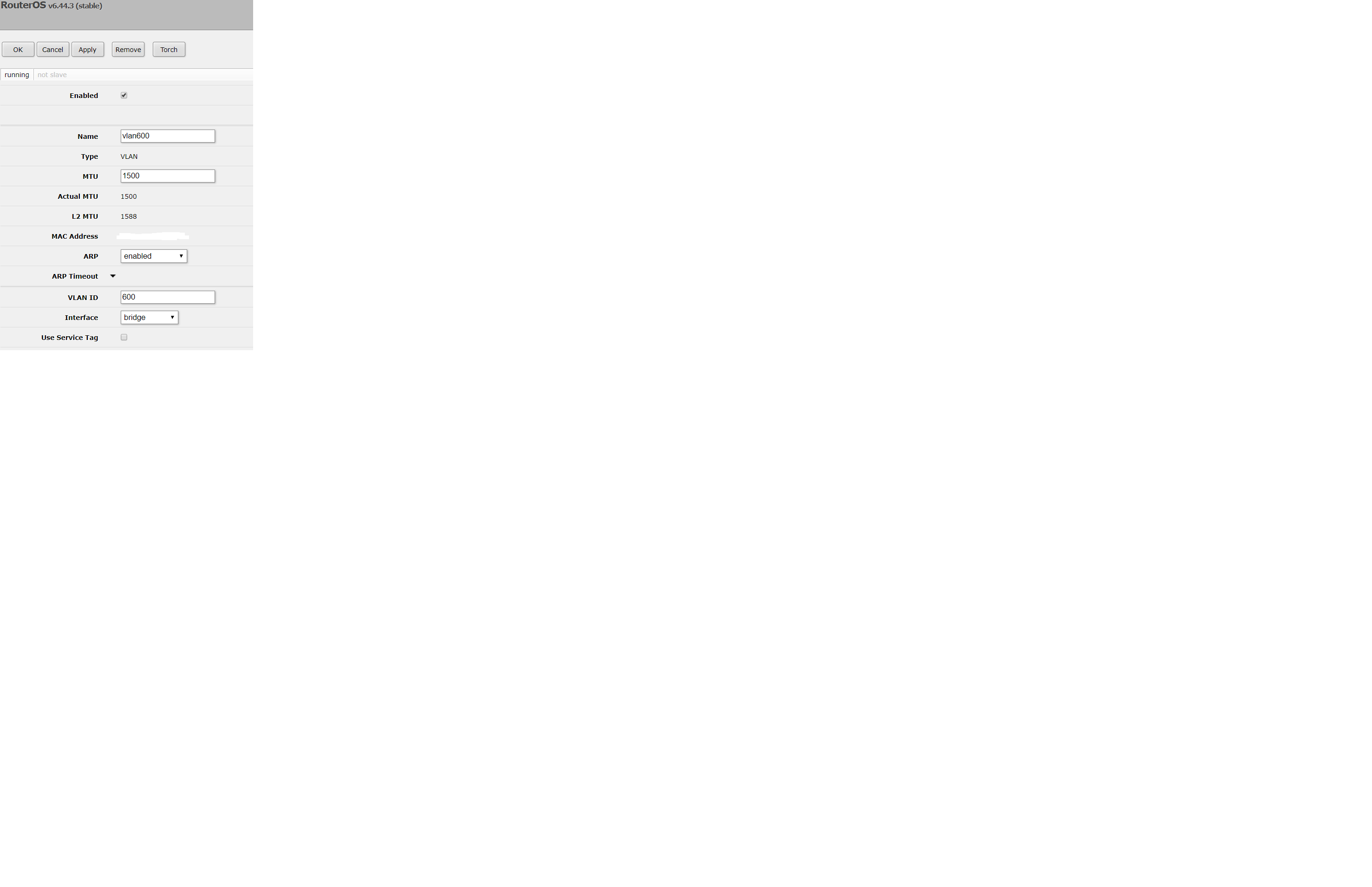

the VLAN interfaces are “virtual interfaces” so you have to define the interface it should get connection from. see attached image.
Also - did you set IP address on the VLAN interface?
You have to make VLAN interfaces for each VLAN you need connectivity from a dhcp server on.
And you have to make a new dhcp server for each vlan/pool you want to serve.
