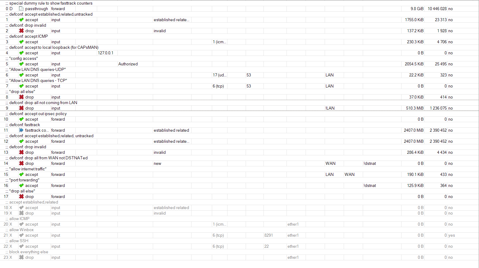

I have the WAN coming in ether1, a trunk port for ether2, a management interface on ether3, and want an access port for vlan 20 on ether5. I’m expecting the TP-LINK TL-SG108E to pick up an IP from the management vlan99 (PVID 99 on ether2), but it does not. Neither does the device on ether5, which should pick up an IP from vlan20. I haven’t enabled vlan filtering yet, since I just want to make sure DHCP works first.
I’m not sure if it’s the firewall rules causing issues, or if I made another mistake, but I appreciate anyone’s help to get things configured properly. Thank you in advance!

A few notes: It was advised to remove PVID 99 from the trunk port, ether2. However I wanted to make sure that the switch management traffic that was initially untagged found it’s way to the right subnet. I’ll change it once all configuration is done. However, temporarily changing it back to PVID=1, makes no difference for winbox.
If anyone has any suggestions as to why I cannot access winbox from any vlan currently I would appreciate it.
As a side note, all of my devices on different vlans can currently communicate. I didn’t think this was allowed by default, so if there is any insight there that would be appreciated as well.
(1) It makes zero sense to send a hybrid port to a managed switch. Get off the drugs!
All vlans should be tagged to the managed switch on the trunk port.
add bridge=vlan-bridge comment=defconf interface=ether2 ingress-filtering=yes frame-types=admit-only-vlan-tagged
add bridge=vlan-bridge comment=defconf interface=ether5 pvid=20 ingress-filtering=yes frame-types=admit-priority-and-untagged
set discover-interface-list=Trusted
/interface bridge vlan
add bridge=vlan-bridge tagged=vlan-bridge,ether2 vlan-ids=40,50,60,99 { you only need one line for this }
add bridge=vlan-bridge tagged=vlan-bridge,ether2 untagged=ether5 vlan-ids=2
(2) Your Interface list members is wrong and needs adjustment to the following:
add interface=service-vlan20 list=LAN
add interface=IOT-vlan40 list=LAN
add interface=trusted-vlan50 list=LAN
add interface=guest-vlan60 list=LAN
add interface=management-vlan99 list=LAN
add interface=management-vlan99 list=Trusted
add interface=trusted-vlan50 list=Trusted
add interface=ether3-mgmt-port list=Trusted
(3) Get rid of this static DNS setting…
/ip dns static
(4) Modify input chain rule for better security.
REPLACE FOLLOWING:
add action=drop chain=input comment=“defconf: drop all not coming from LAN”
in-interface-list=!LAN
With:
add action=accept chain=input src-address-list=Authorized comment=“Config Access”
add action=accept chain=input comment=“Allow LAN DNS queries-UDP”
dst-port=53 in-interface-list=LAN protocol=udp
add action=accept chain=input comment=“Allow LAN DNS queries - TCP”
dst-port=53 in-interface-list=LAN protocol=tcp
add action=drop chain=input comment=“drop all else”
{ add only after admin allow rule and firewall address list are in place }
The firewall address list is comprised of static DHCP leases and by devices the admin uses…
/ip firewall address-list
add address=10.10.50.X list=Authorized comment=“local admin desktop”
add address=10.10.50.Y list=Authorized comment=“local admin laptop”
add address=10.10.50.Z list=Authorized comment=“local admin ipad/smartphone”
add address=10.10.99.X list=Authorized comment=“admin when on mgmt network”
add address=192.168.99.0/24 list=Authorized comment="admin connecting from ether3
THe users on the network ONLY need access to DNS services…
(5) You have duplicate input chain rules ALL THAT NEED TO BE DELETED>
Look after this rule in the forward chain and you will spot them.
“defconf: drop all from WAN not DSTNATed” connection-nat-state=!dstnat
add action=accept chain=input comment=“accept established,related”
add action=drop chain=input connection-state=invalid
add action=accept chain=input comment=“allow ICMP” in-interface=ether1
protocol=icmp
add action=accept chain=input comment=“allow Winbox” in-interface=ether1 log=
yes port=8291 protocol=tcp
add action=accept chain=input comment=“allow SSH” in-interface=ether1 port=22
protocol=tcp
add action=drop chain=input comment=“block everything else” in-interface=
ether1
(6) Speaking about the last rule in the forward chain, we are going to modify it for clarity and better security so dump it and replace with the following.
add action=accept chain=forward comment=“allow internet traffic” in-interface-list=LAN out-interface-list=WAN
add action=accept chain=forward comment=“port forwarding” connection-nat-state=dstnat disabled=yes {enable if required}
add action=drop chain=forward comment="drop all else
(7) Dont see the purpose of this entry? If there are no values entered in for winbox, that means there are NO restrictions, and all possible IP addresses have access at least to the extent that this part of overall security allows all users. Thus no entry and 0.0.0.0/0 amount to the same thing.
set winbox address=0.0.0.0/0
Much better to actually include subnets where the admin will be located to access the Router for config purposes.
Aka Management SUBNET, TRUSTED SUBNET and ether3 subnet.
set winbox address=10.10.50.0/24,10.10.99.0/24,192.168.99.0/24
(8) If not using IPV6 ensure you disable it and replace all the ipv6 firewal rules with
add chain=input action=drop
add chain=forward action=drop
(9) At the bottom of the config, mac-server is not a secure method of access and thus only mac-server mac-winbox should have Trusted entry
fixed…
/tool mac-server
set allowed-interface-list=NONE
/tool mac-server mac-winbox
set allowed-interface-list=Trusted
First, thank you so much for taking the time to help an internet stranger with their issues, it means a lot to me! I think that solved the issue of being able to log in to winbox, as I’m now able to log in from my laptop on 10.10.50.4 from a wireless access point, through a switch, into ether2 of the router, so great!
Thanks for taking a look at those firewall rules as well. I tried my best to implement them, however I’m still slightly confused and want to ensure that I did not misconfigure them (I want to avoid my router being publicly accessible lol).

And for clarity an image of the ipv4 firewall:
I left some things in place like the “drop all not coming from LAN” because I wanted to make sure that the other rules were in place correctly, especially since this rule is catching packets.
Please let me know if everything in the firewall or config is in place correctly.
Additionally, I noticed that I can still ping across vlans. For example, from my laptop (10.10.50.4) to my cell phone (10.10.60.2). My understanding was the vlans had to explicitly be allowed to communicate with firewall rules, and that by default they wouldn’t be able to communicate. Is this because they’re all on the same bridge and normal behavior? If so I assume I can just create firewall rules to prevent, for example, the IOT vlan being able to communicate with the management vlan.
Thanks again for all your help, it’s greatly appreciated!
(1) This rule is no longer required in the input chain…
(2) You made the same error in the forward chain, you DIDNT get rid of the old rule that we replaced. Get rid of it!!
add action=drop chain=forward comment=“defconf: drop all from WAN not DSTNATed”
connection-nat-state=!dstnat connection-state=new in-interface-list=WAN
(3) Why do you have all the old rules at the bottom still on your CONFIG… get rid of them…
connection-state=established,related disabled=yes
add action=drop chain=input connection-state=invalid disabled=yes
add action=accept chain=input comment=“allow ICMP” disabled=yes in-interface=
ether1 protocol=icmp
add action=accept chain=input comment=“allow Winbox” disabled=yes in-interface=
ether1 log=yes port=8291 protocol=tcp
add action=accept chain=input comment=“allow SSH” disabled=yes in-interface=
ether1 port=22 protocol=tcp
add action=drop chain=input comment=“block everything else” disabled=yes
in-interface=ether1
Should work fine now.
For the admin firewall address list, if you are the only user on the subnets fine to leave it, but if they are shared, then best to detail only your devices.
