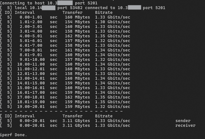

My RB5009 could achieve 1.3 Gbps acting as one of the two WG peers in a WG connection. Which means something is wrong with your configuration.

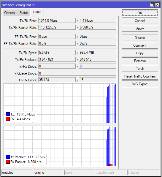

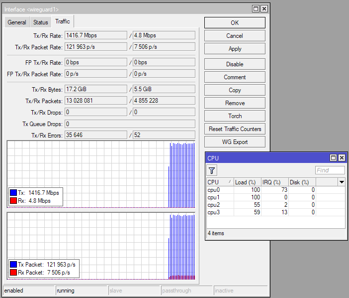

As for the RB5009, with 100% on two cores it can handle 1.4Gbps on the Wireguard interface. I also tested with iperf3, but the Windows version, on both ends. WG MTU is 1420, outer MTU is 1500. Which means the problem you encountered is not related to the CPU.

Very interesting, I have my CPU frequency set to auto, and the frequency normally jumps between 350MHz and 1400MHz and could still achieve those 1.3+Gbps numbers.
However, @dang21000 post made me consider my configuration again. My configuration currently has fasttrack enabled but not working, see my post here and @EdPa post right below it:
https://forum.mikrotik.com/viewtopic.php?t=212754&start=300#p1118471
Which means fasttrack is not really active. As a test, I disabled DHCP Snooping on my bridge to restore a functional fasttrack, and the same test that I performed through WG produces significantly worst numbers, with throughput values jumping up and down with every report line (every second) between a few hundred Mbps and over 1Gbps, but very inconsistent and as a result, the average is only under 1Gbps. Disabling fasttrack restores the consistent 1.3+Gbps figure.
It looks like fasttrack causes less load on the CPU, but still with spike (because not all packets can be fasttracked) as a result the CPU is downclocked (due to lower utilisation), and then cannot raises the clock fast enough when a spike is needed.
I made further tests, and with fasttrack enabled, but CPU set at a constant 1400Mhz, the throughput is more consistent, but still markedly lower than with fasttrack disabled! I got nearly constant 9xx Mbps values, instead of 1.3+Gbps. Which means fasttrack enabled causes the WG throughput to be about 30% lower.
