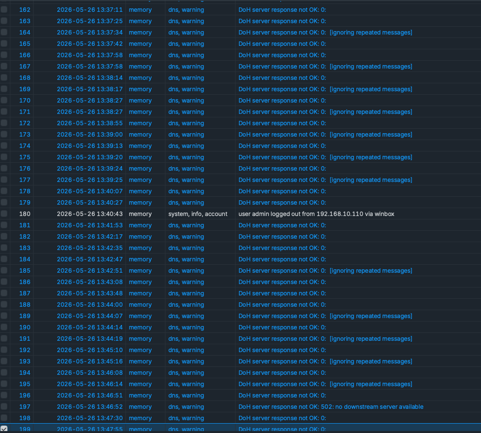

I have been waiting for HTTP/2 DOH support for Quad9 for a while now. When I enable it on stable RouterOS 7.23, it appears to work, but my router logs fill up with lots of these errors. Anyone else seeing this? I have disabled DOH for now, as this makes the logs not very effective.
I have the same logs.
I can't say for sure if DoH is actually working.
Seems like it works properly for me. I don't have regular DNS set up at all, and have disabled "Use peer DNS" in every WAN config, so it definitely has no way to fall back to regular DNS. Instead I have dns.quad9.net manually mapped to 9.9.9.9 and 149.112.112.112 in static DNS entries. Though I also get a lot of these DoH server response not OK: 0: warnings.
What I did to clean up my logs was to set up a separate logging memory action named dns, and logging rules dns, info, dns, error, dns, warning with the dns action, then add !dns to the default rules, and filter the log with "buffer is not dns". Though it would be better if Mikrotik fixed this.

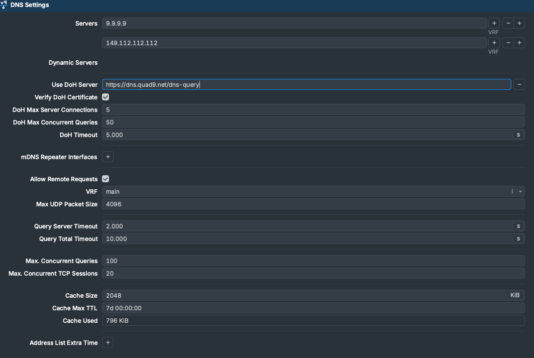

/ip/dns set cache-size=22528 doh-max-concurrent-queries=50 doh-max-server-connections=5 doh-timeout=7s servers="" use-doh-server=https://dns.quad9.net/dns-query verify-doh-cert=yes
Resulted in 394 "DoH server response not OK: 0:" lines (out of 731 log lines since Jul/17/2026 02:59:31).
Increasing/decreasing the numbers in
did not improve the situation. board-name: hAP ax^3
