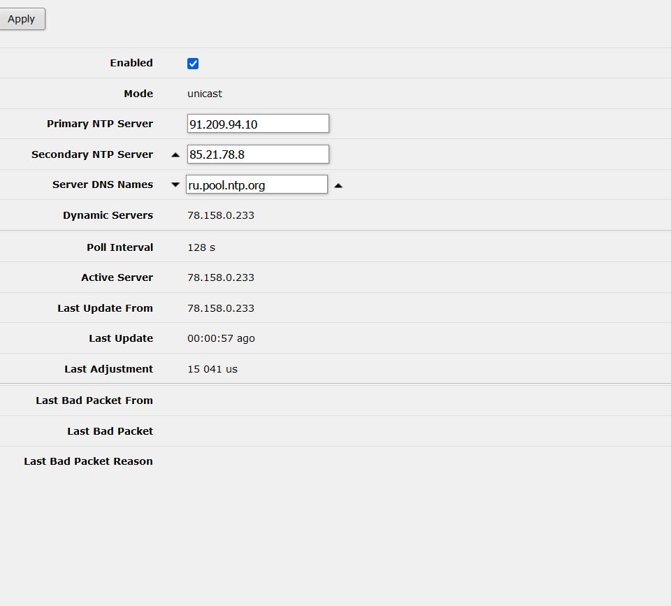

I’ve tried to google this problem, I saw that there are two main problems:
no system time set and no certificates are acquired.
But my system configuration pulls them both:
I could post part of my configuration, just tell me what to display.
Thanks!
