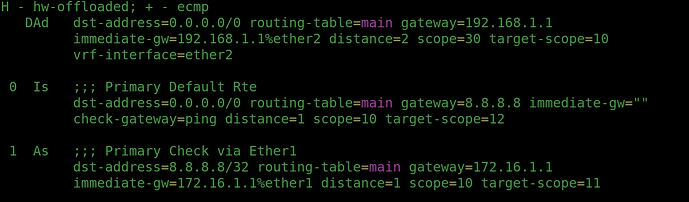

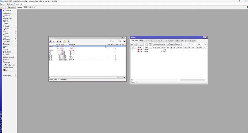

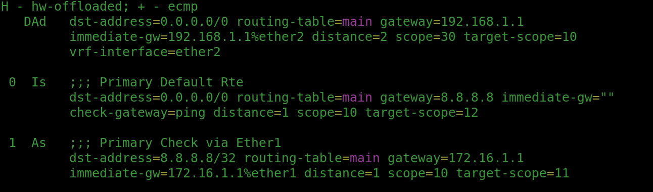

I have followed that. This image is showing the issue:
the /32 route for 8.8.8.8 remains active in the routing table because the next hop is still reachable. The default route does fail over because of the gateway check. If I DST a packet to 8.8.8.8 I take the primary circuit which in this scenario is the "failed" one. This is fine if the link drops, but if the link remains online and the internet is no longer operational I cannot reach that one specific destination (8.8.8.8) everything else that's not a /32 in the table fails over.
Hey @jaclaz thank you for the response. I read through that and it if I am reading it correctly the simplest way to remember is the narrow scope (canary) can be 11 and the catch-all or wider scope needs to be +1? I implemented that but unfortunately getting the same results.
I think the results you are getting is what you should expect. If you still need to access your recursive route "monitor" address of 8.8.8.8 during a failover scenario, then you should pick something besides 8.8.8.8 to use in your recursive route.
You can pick 8.8.4.4 for instance, or something other than google dns if you will be using that on your network as your dns provider.
Thanks Kevo, I will just accept that then. Appreciate the response.
