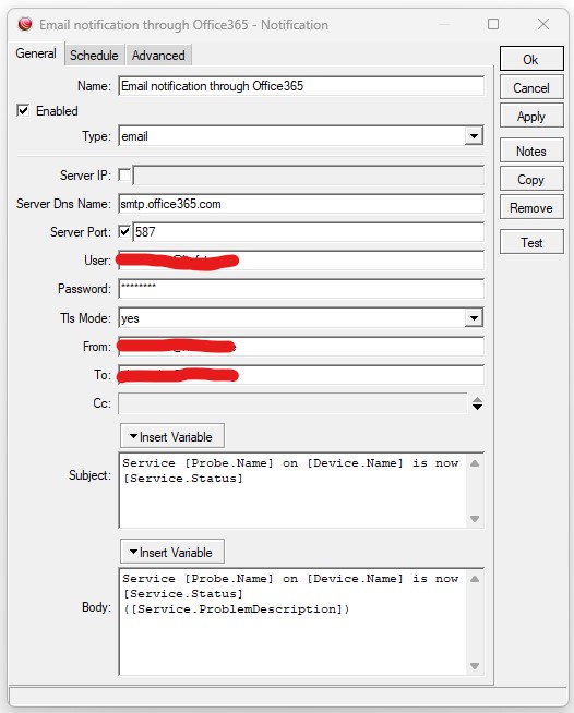

Hi guys! I’m trying to set up email notifications but I can’t get it to work. When hitting the test button I’m not getting any emails. I’m using The Dude version 6.49.4. I’ve triple checked the password, obviously. What am I missing?
Not sure if SSL StartTLS is supported, have you tried on the unencrypted ports ?

No, I haven’t. What ports are those? I tried 465 but that didn’t work either.

Just did a test using Outlook account accordingly to the documentation configuration settings - POP, IMAP, and SMTP settings for Outlook.com and settings are similar to the 365 - POP, IMAP, and SMTP settings.
CHR 7.7 / Dude 7.7 - Tls Mode: yes
With ‘Tls Mode: tls-only’ an error appear int the ROS logs.
