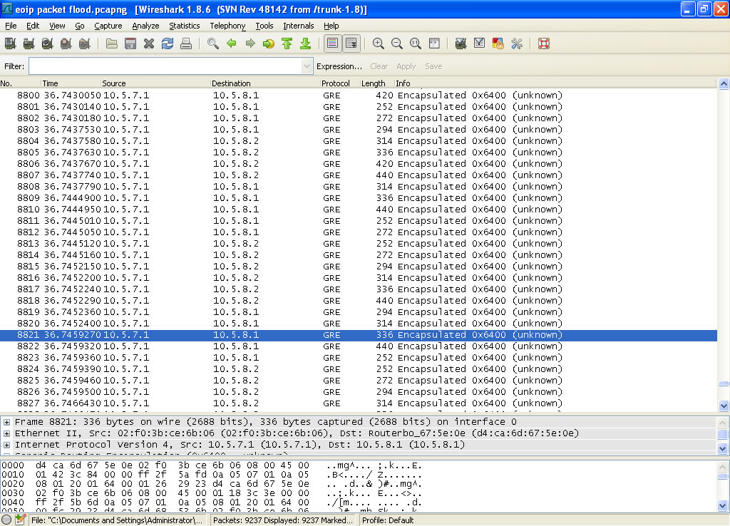

Screenshot of eoip -gre packet flood when I unplug the cable between the two routers.
check the time on the packets, its crazy :open_mouth:

can you add pcap file with one packet or several packets for inspection?
Its all routerboard. RB750GL configured to be a hotspot (10.5.7.1/16) and RB751U-2Knd (10.5.8.1/16, latest version of ros does the same thing only worst, it cause the device to reboot all the time.
eoip packet flood.zip (222 KB)
This issue only occurs when I unplugged the ethernet cable between them or when 10.5.8.1 shutdown / reboot, when I disable the hotspot, the problem is gone! I dont get it, its if the hotspot freaks out eoip, on my firewall, gre is allowed, its the first rule, so its not getting blocked by the hotspot rules
