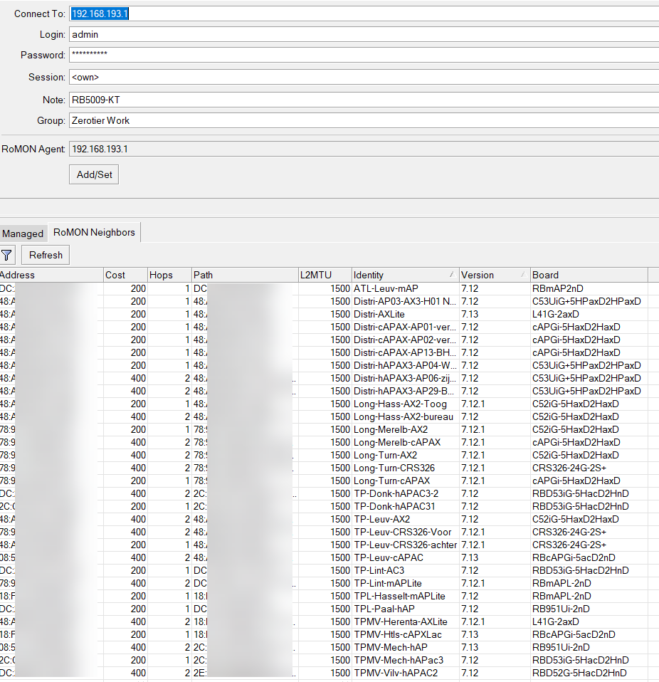

Basically yes is my impression. I did it just for fun and was tired of looking on a cheat sheet the IP address and Port assigned to natted router, and a remote MT router and throiugh EOIP & Romon I dont need to… A bit of a lazy approach but if one has many routers/devices not on the directly connected nework, it would be a godsend.
Work ROMON. There are 68 entries there.
I start with zerotier or wireguard to that main router (whatever), and then it’s all ROMON or over EOIP.

The slight pain in the ass of having to half log into one router to see be able to hit the connect to romon button is well worth it when you see 68 routers show up on the list.
