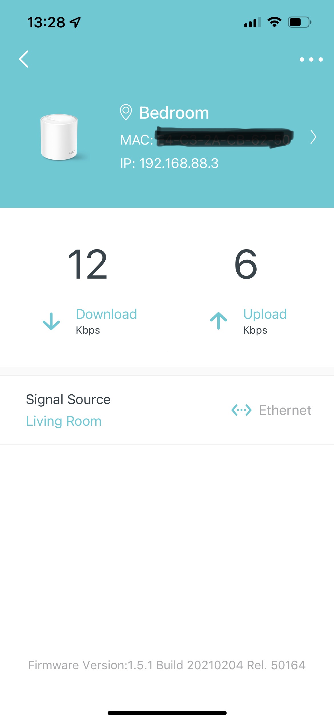

I managed to re-create the network - hexPoe and both Deco’s connected individually, directly to hex, main in port 2, slave (bedroom) in port 3.
The screenshot is taken within Deco app, from the 2nd unit.

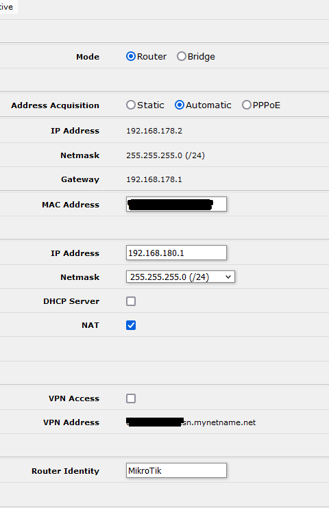

Show Mikrotik settings
ah, this is how I can include images
All is default except form this
and this
I tried to play around with this checkbox,
but it doesn’t save
