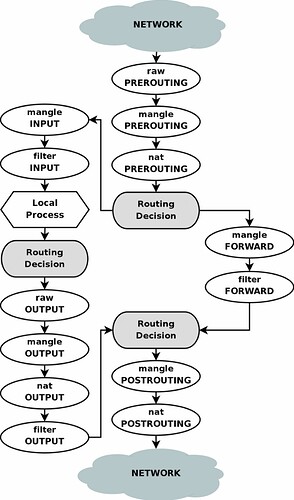

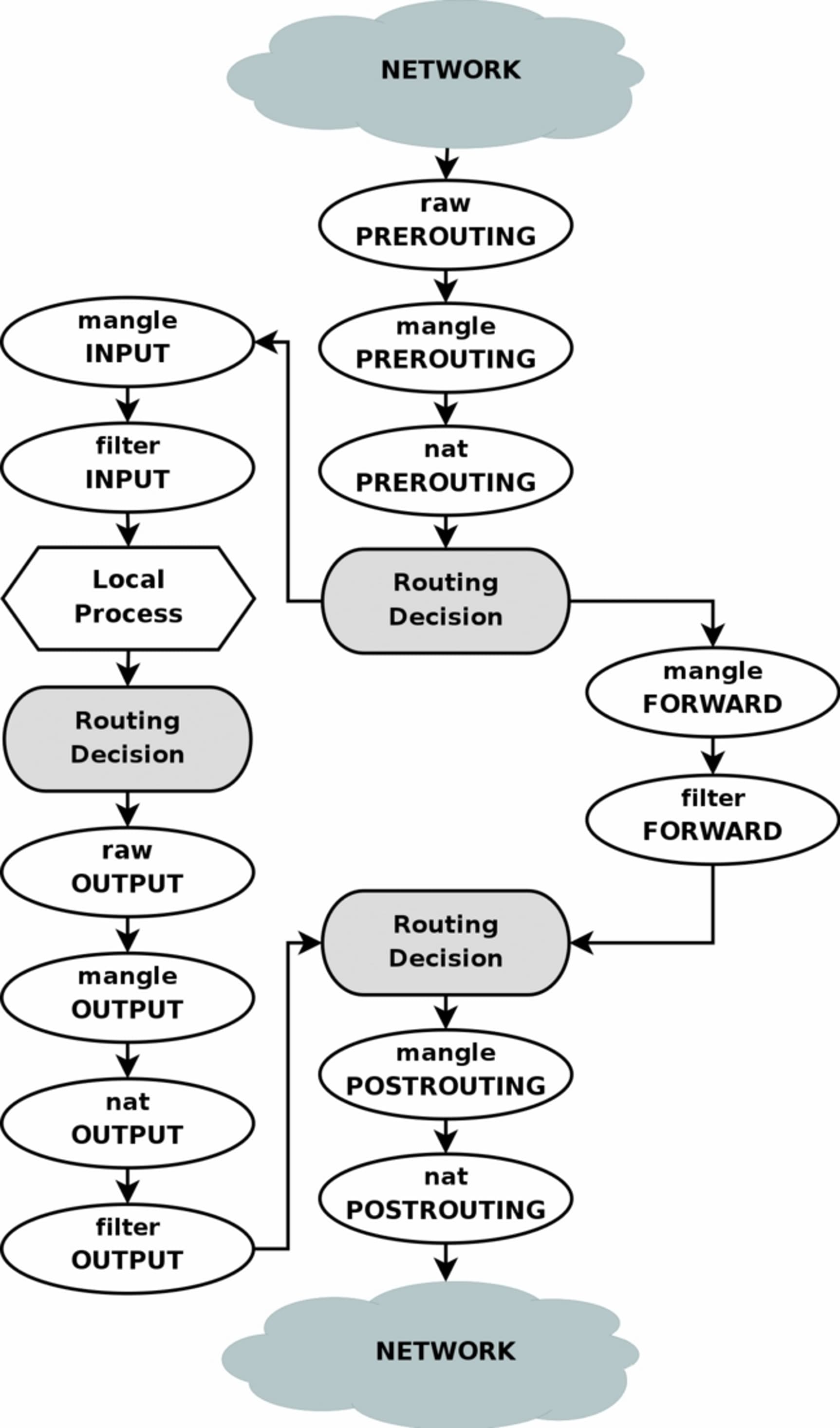

There are many Linux netfilter flow diagrams online and of course MikroTik packet flow chart. But I often use this one for quick high-level overview without unnecessary details. It’s especially useful when doing NAT and mangle to see the order of processing. Just FYI, this is plain Linux iptables diagram, so terminology might differ somewhat from MikroTik.

The Linux firewall has lot’s of functions and it can be bewildering. Even for more complicated networks these chains are usually enough to know about:
  • filter/input - packets where the router itself is the recipient
  • filter/forward - packets that go through the router (not generated or received by the router itself)
  • nat/srcnat - this is where translation from internal addresses to internet routable addresses happens
Usually the next one to come up is:
  • nat/dsnat - this is where what most routers call “port forwarding” happens
The other chains are used in specialized scenarios.
The packet flow diagram specifically constructed for Mikrotiks: The ultimate Mikrotik iptables flowchart
