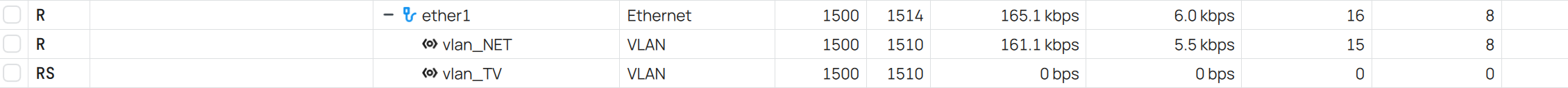

I am now familiar with Mikrotiks for a few years, yet VLANs are still messing with my brains. Recently I did find out VLANs, that one of our ISPs are using, so that I am able to get rid of their Modem+Router and bring the internet directly to Mikrotik device. The situation is as:
On WAN port I put on VLAN for Internet
And the same VLAN for IPTV
I have both correct info, and I know it works, because I tried it to bridge with other ETH interfaces, and everything works fine.
Now the real question for me is: when I bring in the internet via NET vlan, I call out with PPPoe, and I get nice Route automatically. BUT! IPTV VLAN is not requested to dial anything I just put it on
WAN interface and there it is. My question here is, how can I forward those VLAN via hardware filtering to other devices? How can I do that? What do I put in the bridge?
