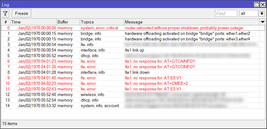

I am seeing some instability with latest modem firmware now (16121.1034.00.01.01.05)
lte1 disappears from interfaces list after 5-10 mins and it’s simply gone.
In Resources however, there’s still a Fibocom FG621-EA visible.
Only resolution: reboot
Observed on 7.13.3 and 7.13.4
When turning on lte logging, it looks like the modem is trying and trying (sending AT commands) but nothing happens.
But it could also be the famous ‘modem boot loop’ observed in the past, where people were told to RMA the box.
(I can’t believe that - but read below)

07:48:59 lte,error lte1: no response for: AT E0 V1
07:49:19 lte,error lte1: no response for: AT E0 V1
07:49:39 lte,error lte1: no response for: AT E0 V1
Upgraded again from 7.13.3 to 7.14b10.
No dice.
Reboot again (to be sure routerboot was upgraded as well).
08:10:19 lte,error lte1: no response for: AT+GTCAINFO?
08:10:19 lte,info lte1 mbim: error: wdm send failed: 19
(don’t mind timings w.r.t. previous loggings, it’s not synchronized yet so the times are completely off)
