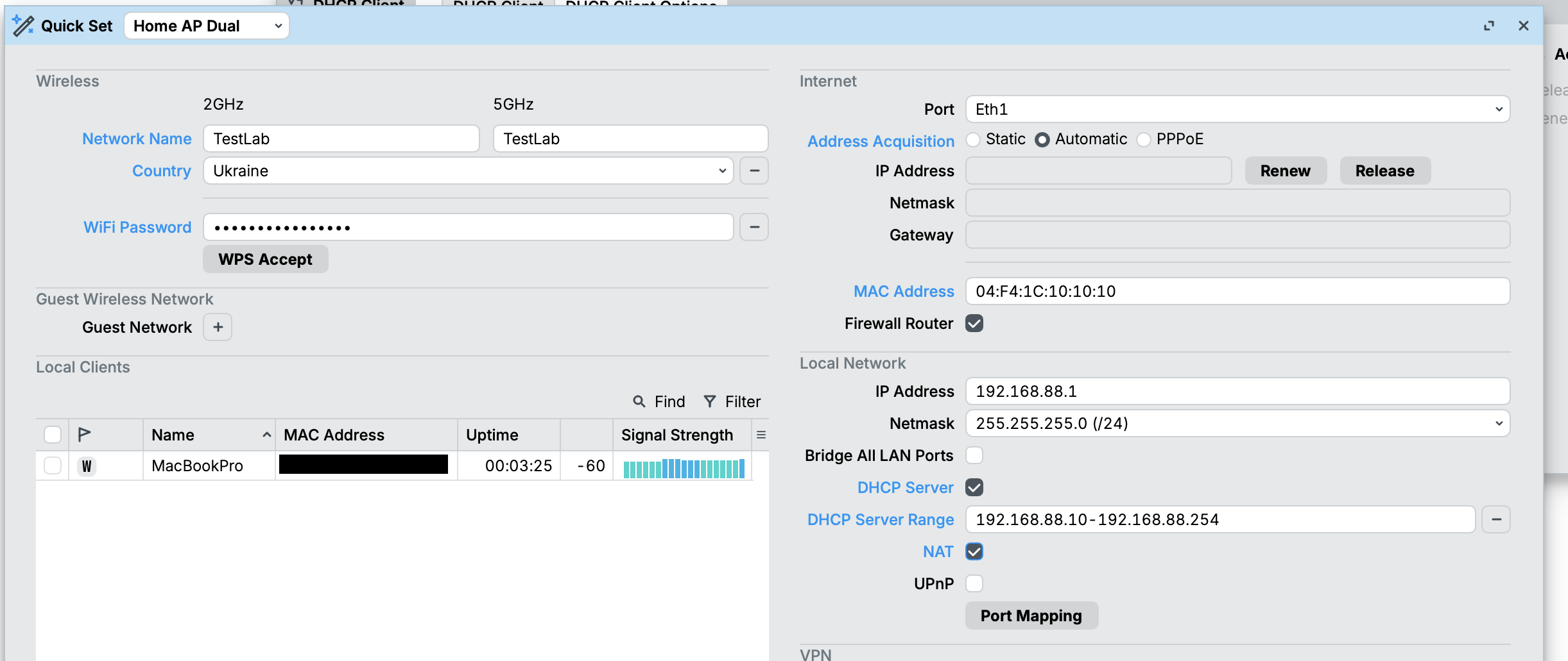

Hi all!
I am fully aware that it is not the best idea to use Quick Set (especially after any changes have been applied outside of it), but I usually use it to set initial configuration on a new router (or after reset), like changing MAC address on internet interface. There was no problem doing so with hAP ax^3 and a couple of ax lite, but with a brand new hAP ax S it seems to be different. I connected ISP cable to ether1, switched it on, accepted default configuration, opened Quick Set and it weirdly showed that Internet mode was set to Static (I needed Automatic, which I think is always the default) with IP 192.168.88.1 (which is LAN one) and gateway 0.0.0.0 (highlighted in red) using Eth1 interface, although I checked DHCP client and there was an active one for ether1 and internet connection was available on wireless client. I decided it was just a Quick Set glitch, so I switched mode to Automatic and it messed a lot of things:
  • router lost LAN IP
  • all the internet interface configuration was applied to ether2 for some reason (in Quick Set you have a choice of Eth1 and SFP1 only for internet interface, which is understandable), it even removed ether1 from WAN interfaces list and replaced it with ether2
  • DHCP server, NAT, firewall settings in Quick Set were messed up
I understand Quick Set tends to mess up the configuration, but the initial / default one?
Has anyone encountered such an issue? I wonder if this is a software or hardware problem? I have a gut feeling that it might be a bug in Quick Set, hAP ax S is a very fresh and immature piece of hardware, but still concerned if it can have something to do with ports wiring.
As a workaround I switched to using ether2 as a WAN interface, this way it at least correctly shows leased IP in Quick Set and I can apply other changes there without messing everything up.
All of it was tested and reproduced both on the original ROS (7.19) and after upgrading to 7.20.6 (both packages and firmware). Btw, is it ok that Factory Software version (7.19.4) from System -> Resources is not equal to Factory Firmware (7.19.5) from System -> RouterBOARD?
It's a rather new device so probably not too many who encountered this issue.

I did factory reset, reconnected ISP cable back to ether1, added changes in Quick Set (adding screenshot to indicate what exactly has been changed) and applied, surprisingly ros upgraded to latest version automatically after this, but maybe there’s an explanation for that.
Posting config after applying, created it using /export file=config.txt command, if the default configuration is needed instead - I will add it (tried adding it, got an error that it was too large and as a new user I cannot upload that for some reason, maybe use some pastebin service?)

It surely messes things up between ether1 and ether2.
MAC address you specified gets applied to ether2 whereas you clearly indicated it should be ether1.
No fixed IP address assigned to neither ether1 nor ether2
DHCP client also gets applied to ether2 instead of ether1.
ether2 is taken out of bridge in port settings.
Looks like a bug to me. Worthwhile to make a ticket out of it so support can have a look at it.
