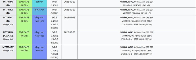

Another WiFi 6 AP with no 160mhz support
Depending on version of MT7976 it should support 160MHz
