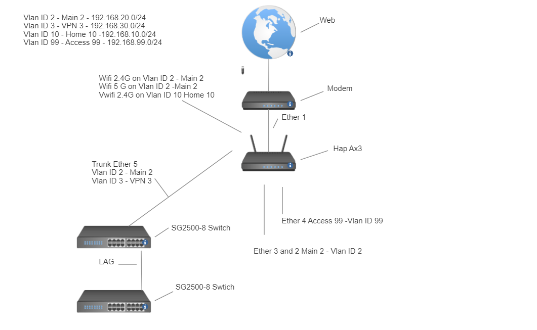

P.S. Please save me
(1) Provide a network diagram it helps you visually plan your network and is a great communication tool. It is very unclear what your traffic flows are…
(2) Take one port and put if OFF bridge for now, to configure the router for bridge and emergency access. Since you have other switches you should be able to free up port5 for example.
(3) Dont mix apples and oranges something doesnt fit 192.168.88.0… either get rid of it as a default crap still hanging around or make it a vlan. The bridge should only do bridging and not dhcp etc… However I dont see where you use that subnet anywhere? Clearly that points to a problem.
(4) Bridge is not a lan list member, only the vlans.
(5) For all your vlans, you only use two of them vlan2 and vlan10, what is the purpose of 3,4 and 69???
Okay so you have ether5 acting as a trunk port but your bridge port assignment is incorrect in that regard.
(6) Interface bridge vlans is screwed up… big time… needs work.
(7) Firewall rules are less than optimal…and somewhat disorganized/incomplete.
(8) WWW is not a secure protocol and should be removed… other than winbox and SSH (and SSH not required if wireguard is up and running) all should be disabled.
(9) IPV6 should be DISABLED if not using.
(10) Mac-server is not secure should be set to NONE.
Overall not a bad effort, some cleaning up will get you on the way. First and foremost the diagram will solidify what you put down on the config.
a. identify all the user(s)/device(s) / groups of users/devices ( including remote users and admin )
b. identify all the traffic they should be able to accomplish.
I took off Vlan 4 and 69 and added and access vlan 99. Vlan 3 I want only on the switches for the 2nd port of my server. I tried the suggestion you made but im having a difficult time with interface bridge vlans. I searched the forms to see if I could find someone that posted a working config thats similar to mine so I general idea of how to set it up correctly. Firewall rules is another one of my weak points i’ll try getting a better handle on it once I can get everything connecting together. I appreciate your help.
Ok I think I have made some progress I can now access my devices on the switch and managed to ping them from the Ax3 I had to set native vlan to none on the Trunk port of the switch. Native vlan 2 didn’t work. I did set native vlan to 2 on every port on both switch besides the trunk port. Here is my config so far let me know what you think.

Sorry about that BartoszP I’ll use proper tags. Anav I had removed ipv6, the default DHCp and ip address and turned off unnecessary service, but I had to reload my old config and forgot to remove again that’s my bad. I rebuilt my config using the one you linked as a reference. I do appreciate all the help you are giving I am learning a lot.
# model = C53UiG+5HPaxD2HPaxD
# serial number =
add name="Da Bridge" vlan-filtering=yes
set [ find default-name=ether4 ] name="ether4 Access"
/interface wifiwave2
set [ find default-name=wifi2 ] channel.band=2ghz-ax .width=20/40mhz \
    configuration.mode=ap .ssid="PsyMaster 2G" disabled=no name="Wifi 2G" \
    security.authentication-types=wpa2-psk,wpa3-psk
set [ find default-name=wifi1 ] channel.band=5ghz-ax .width=20/40/80mhz \
    configuration.mode=ap .ssid="PsyMaster 5G" disabled=no name="Wifi 5G" \
/interface vlan
add interface="Da Bridge" name="Home 10" vlan-id=10
add interface="Da Bridge" name="Master 2" vlan-id=2
add interface="Da Bridge" name="VPN 3" vlan-id=3
add configuration.mode=ap .ssid="PsyHome 2G" disabled=no mac-address=\
     master-interface="Wifi 2G" name=Home \
add name=WAN
add name=LAN
/iot lora servers
add address=eu.mikrotik.thethings.industries down-port=1700 name=TTN-EU \
    up-port=1700
add address=us.mikrotik.thethings.industries down-port=1700 name=TTN-US \
    up-port=1700
add address=eu1.cloud.thethings.industries down-port=1700 name=\
    "TTS Cloud (eu1)" up-port=1700
add address=nam1.cloud.thethings.industries down-port=1700 name=\
    "TTS Cloud (nam1)" up-port=1700
add address=au1.cloud.thethings.industries down-port=1700 name=\
    "TTS Cloud (au1)" up-port=1700
add address=eu1.cloud.thethings.network down-port=1700 name="TTN V3 (eu1)" \
    up-port=1700
add address=nam1.cloud.thethings.network down-port=1700 name="TTN V3 (nam1)" \
    up-port=1700
add address=au1.cloud.thethings.network down-port=1700 name="TTN V3 (au1)" \
    up-port=1700
add name="Master 2" ranges=192.168.20.2-192.168.20.254
add name="VPN 3" ranges=192.168.30.2-192.168.30.254
add name="Home 10" ranges=10.0.10.2-10.0.10.254
add address-pool="Master 2" interface="Master 2" lease-time=10m name=\
    "Master 2"
add address-pool="VPN 3" interface="VPN 3" lease-time=10m name="VPN 3"
add address-pool="Home 10" interface="Home 10" lease-time=10m name="Home 10"
/zerotier
set zt1 comment="ZeroTier Central controller - https://my.zerotier.com/" \
    disabled=yes disabled=yes name=zt1 port=9993
add bridge="Da Bridge" frame-types=admit-only-untagged-and-priority-tagged \
    interface=ether2 pvid=2
    interface=ether3 pvid=2
add bridge="Da Bridge" frame-types=admit-only-vlan-tagged interface=ether5
    interface="Wifi 5G" pvid=2
    interface="Wifi 2G" pvid=2
    interface=Home pvid=10
set discover-interface-list=!LAN
/ipv6 settings
set disable-ipv6=yes forward=no
/interface bridge vlan
add bridge="Da Bridge" tagged="Da Bridge,ether5" untagged=\
    "ether2,ether3,Wifi 5G,Wifi 2G" vlan-ids=2
add bridge="Da Bridge" tagged="Da Bridge,ether5" vlan-ids=3
add bridge="Da Bridge" tagged="Da Bridge" untagged=Home vlan-ids=10
add interface=ether1 list=WAN
add interface="Home 10" list=LAN
add interface="Master 2" list=LAN
add interface="VPN 3" list=LAN
add address=192.168.99.1/24 interface="ether4 Access" network=192.168.99.0
add address=192.168.20.1/24 interface="Master 2" network=192.168.20.0
add address=192.168.30.1/24 interface="VPN 3" network=192.168.30.0
add address=10.0.10.1/24 interface="Home 10" network=10.0.10.0
/ip dhcp-client
add address=10.0.10.0/24 dns-server=1.1.1.1,1.0.0.1 gateway=10.0.10.1
add address=192.168.20.0/24 dns-server=1.1.1.1,1.0.0.1 gateway=192.168.20.1
add address=192.168.30.0/24 dns-server=1.1.1.1,1.0.0.1 gateway=192.168.30.1

I’m not sure why its still putting ether 5 in the parenthesis
add bridge=“Da Bridge” tagged=“Da Bridge,ether5” untagged=
“ether2,ether3,Wifi 5G,Wifi 2G” vlan-ids=2
(1) Remove the exclamation mark, you want the LAN interface list to be the discovery list.
set discover-interface-list=**!**LAN
(2) As far as quotation marks are concerned, either you have finger troubles or your router is acting very weird, which one do I presume…
So to alleviate both,
change all your names to NOT uses quote marks… should only be used for comments anyway.
Da-Bridge
Home-10
Master-2
VPN-3
wifi-5G
wifi-2G
ether4-access
(3) Don’t forget to add ether4-access to the LAN interface list!!!
Ohh I did not know that if there’s a space in the name it quotes it. I updated the names, removed the exclamation mark and added ether4- Access to LAN list.
Is everything now working as required? If not post the latest config and let us know what is not working.
Everything seems to be working fine. I left the sids the way they are so I don’t need to re-login from everyone’s devices.

Next i’ll be setting up Mullvad through wireguard on VPN-3. We will see how that goes. I did see in another post you said that if a vpn connection on wireguard drops there is no leak. Is that correct?
That is my understanding…
