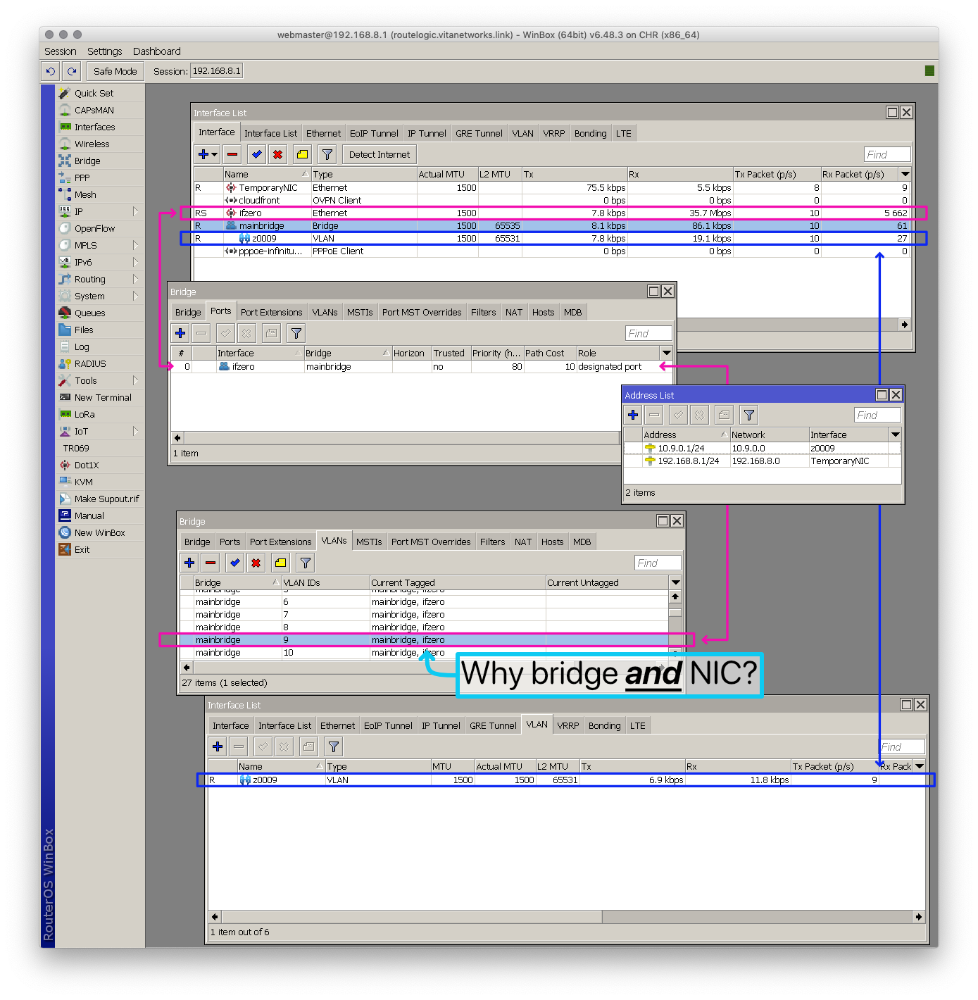

After deleting an “unknown” entry from the Ports tab in the Bridge window, this failed again. I added the NIC in Bridge>Ports and it came back but it shows a different icon–so I might be bridging sideways since both the NIC and the bridge are listed as tagged interfaces. I don’t know. I’d like to know some terminology to stop following guides and set it up on my own, but the wiki is mostly settings without context or a guide that assumes I’m setting up a Mikrotik switch as well or that I have more than one NIC.
I only have one NIC, I added a second one bc I kept locking myself out but it’s going to be just one NIC in the end, one giant trunk interface. The switches are all trunk ports too, LACP trunks to the hypervisors actually, but that doesn’t know CHR. When I tried to ad ports in Bridge>Ports, in addition to the virtual NIC, I also get the VLANs formerly and/or currently slaves of it. So what is the concept of a port? What does it refer to?
Also, must VLANs exist in Interfaces>VLANs in addition to Bridge>VLANs? And if so, which interface (the bridge or the NIC) should be the VLAN’s parent?
This is what finally started replying to ping requests:
Is that how it’s supposed to be? Having different types of interfaces declared as tagged/untagged doesn’t seem right… :confused:
