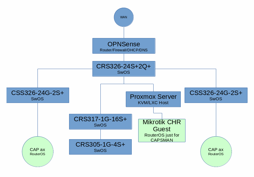

Here is a high level diagram (with non-relevant servers and clients omitted)
Before plugging in the CAP ax units for the first time, I had already configured my CHR VM install to work in bridge mode, assigned it a static IP and enabled CAPSMAN in it.

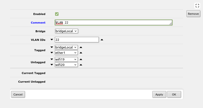

Then I logged in on each of the the CAPs themselves and clicked on the auto-generated bridge (bridgeLocal) and added vlan22 as follows:
Tagged: bridge and Ether1
Untagged: The two slave Wifi interfaces
Also, as mentioned in that thread, I DID NOT enable VLAN filtering in the bridge, as I was told that breaks things.
Now I’m able to get my phone to connect to the SSDI on VLAN22 and it actually pulls an ip from the VLAN22 DHCP, but nothing else can seem to connect to it. Not my Laptop (which connects just fine to the main LAN wifi, with everything the same except VLAN) nor the thermostats this VLAN is for.
Edit:
The phone connecting to the VLAN 22 SSID seems highly intermittent. It works sometimes, but not other times, and the pings on th elocal networkj to the phone when it is connected are all over the place from single digit ms all the way up to 200ms.
