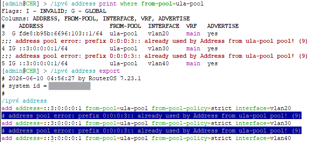

Now the similar test, but with strict instead:
 /ipv6 address
add interface=vlan20 address=::3:0:0:0:1/64 from-pool=ula-pool from-pool-policy=strict
add interface=vlan30 address=::3:0:0:0:1/64 from-pool=ula-pool from-pool-policy=strict
add interface=vlan40 address=::3:0:0:0:1/64 from-pool=ula-pool from-pool-policy=strict
Result:
With strict RouterOS is not allowed to change the subnet-id from the specifed one, as a result, only vlan20 get a valid address assigned. The two other interfaces cannot obtain a prefix from the pool, because they explicitly ask for subnet-id 3 and that one is no longer available in the pool.
