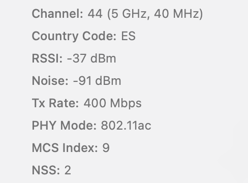

So I found “Tx Rate” in the macOS Wifi UI:

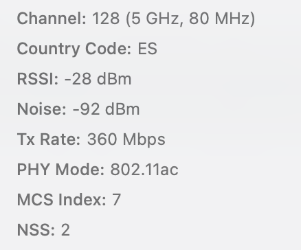

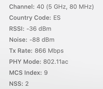

When I change the channel width to “20/40/80mhz-XXXX” I see the “Tx Rate” increases:
And speedtest.net goes up to 400+ mbps. This is quite good!
But after AP reboot (just to confirm it still works), the speed goes back to ~100 mbps. I notice that the channel is different and the Tx Rate dropped. I guess I should really do the frequency scan next.

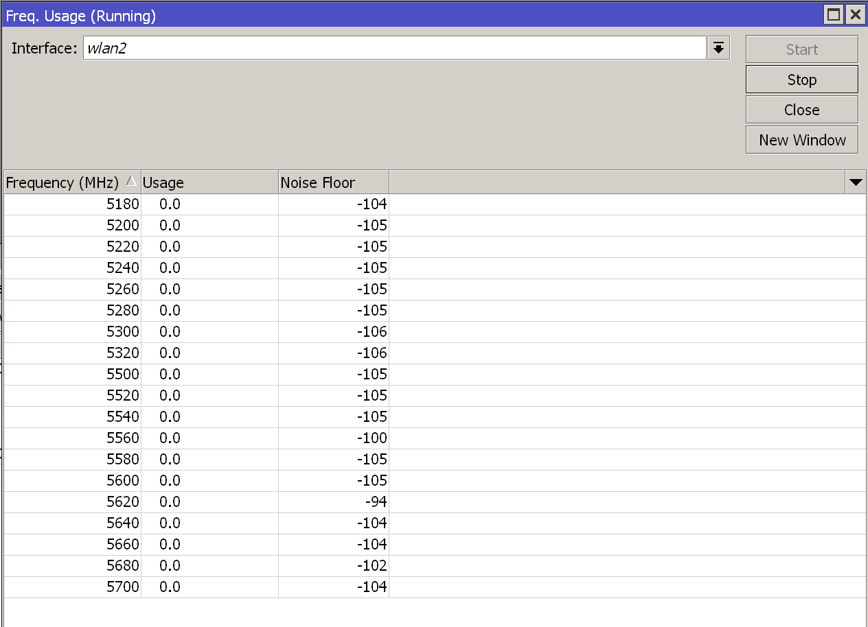

Scanner does not find anything in the 5ghz range.
Freq. Usage reports the following:
Suburban location, detached house.
So your basically alone there :laughing:
See how it goes setting that frequency fixed and using 20/40/80
This helps make the speed more stable. It goes above 200 mbps even after multiple tests, reboots, yay!
