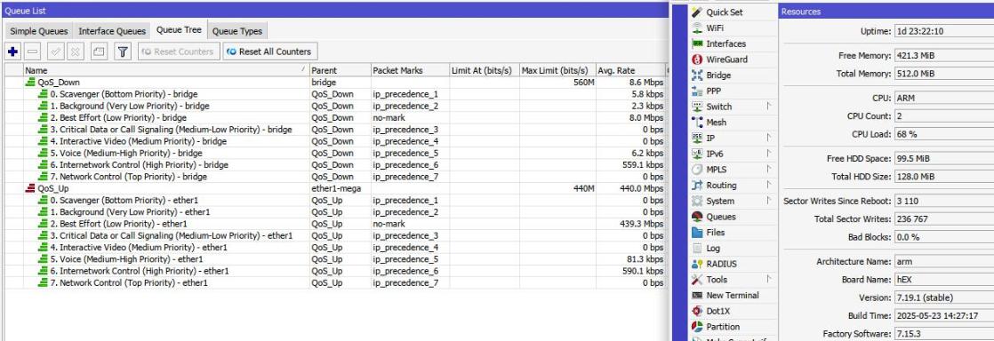

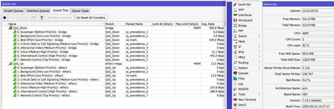

Mine happily pushes 540 mbps down, 440 mbps up through WAN with a QoS fq_codel queue tree. Cpu is not maxed - reaching like 80%.
That’s roughly in line with what I would expect.
