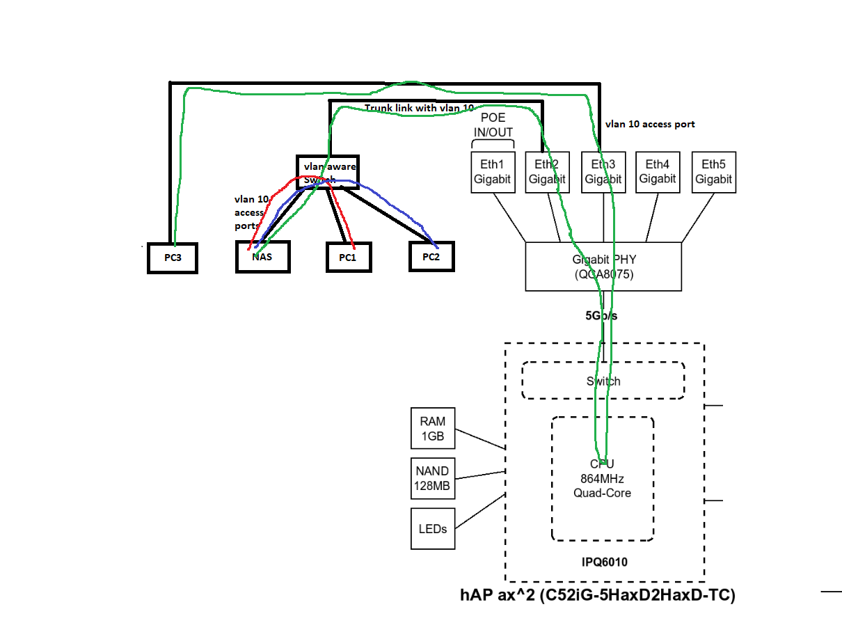

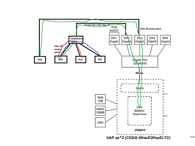

The Hex Refresh has an EN7523 switch (see this). So that supports HW offloaded bridge and should handle intra-vlan traffic in the EN7523 chip included in the SoC. The hapax2 switch chip is not supported by ROS, and I don't even know if the switches "PPE" packet processing engine has the ability to process vlan tags; I have seen conflicting information. But ROS does not currently support vlans in hardware on the IPQ6010.
This shows the data path of intra-vlan traffic when going between vlan interfaces on the hapax2 vs going through an external vlan-aware switch.
If you are not doing massive transfers between pcs and the NAS (backups, graphics editing, etc) then you probably won't notice the difference. I don't know what will happen if the CPU gets saturated with IRQ processing, probably packets will be dropped. But if you find it is a problem, you can put a 5 port vlan-aware switch connected to the hapax2 and then connect your other switches to it. That should then prevent the (vast majority of) intra-vlan traffic from hitting the hapax2 interface. And unless you have other plans for the ER-X, it could fulfill that role without having to purchase another switch.
