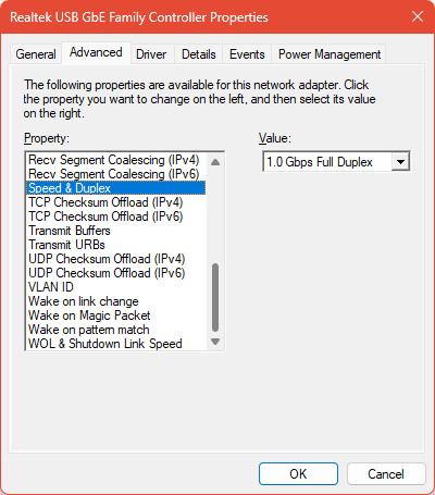

Did you try plugging the adapter into the Windows 11 laptop, install the latest driver from Realtek USB FE / GbE / 2.5GbE / 5G / 10G Family Controller Software (get the NetAdapterCx version). Go to the adapter properties in Device Manager and turning off all
  • Adaptive Link Speed
  • Advanced EEE
  • Energy-Efficient Ethernet
  • Green Ethernet
  • Idle Power Saving
settings?
And the adapter also allows you to force the link speed to 1Gbps Full Duplex:
Maybe you can try that too.
