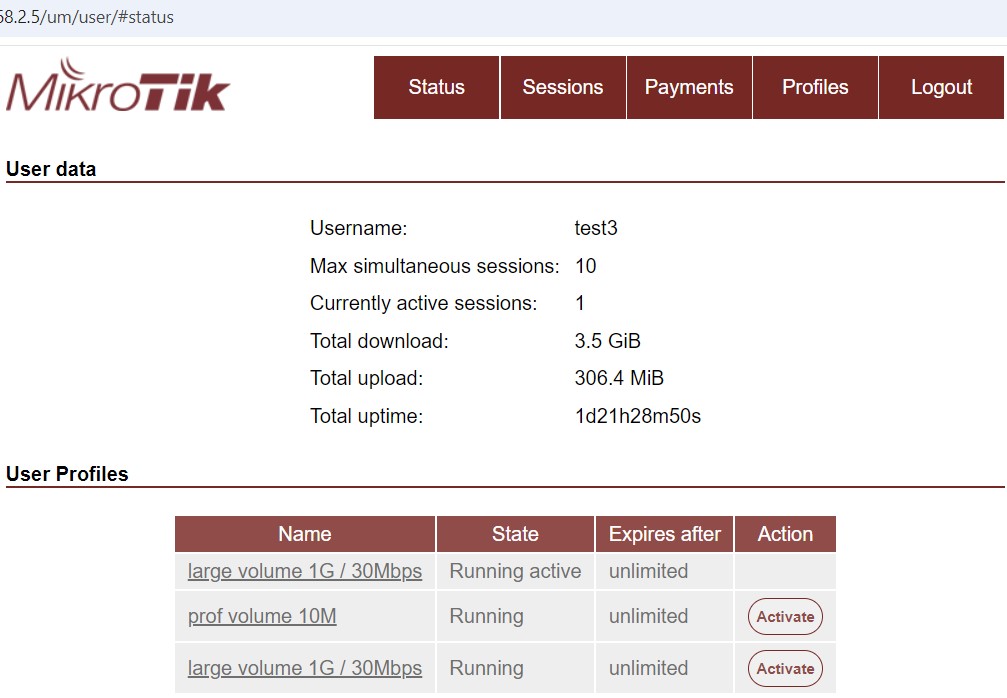

Bad news: did not find any way to see what part of the volume limit had been consumed. Not by the ROS manager (eg in Winbox), nor by the end-user (The UM web interface for the user)
Only the logging says the counter has been reset.:
User gets no info (probably user can change profile, or even buy profiles, but that is not the scope of the experiment)

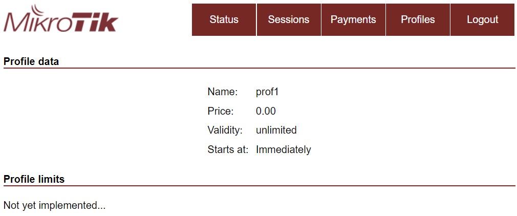

ROS version 7.10.2 … profile limit information … not implemented yet … but it works ! With user and manager left in the dark. Unless someone can point me to the place where to look. CLI maybe?

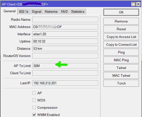

By lack of documentation on “User Manager” and the Mikrotik attributes … a little experiment.

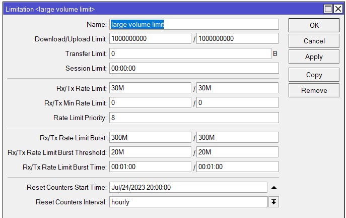

Created a “volume” limit in User Manager, but this time also added “rate” limits.
This limitation was linked to the username for wifi PEAP login, and was also linked to the MAC address, for DHCP with RADIUS

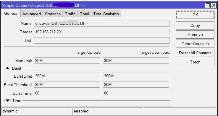

The TX/RX rate limit was initialy set at 30K , and that was a problem (30Kbps (bits) , old modem speed)
So bad, that WinBox only showed empty windows (Window appears but no data at all, the first minutes)
What happened?
The DHCP linked limitation created the simpe queue as expected, on the MT with the DHCP server.
DHCP server probably supposed to be on the edge router, so this is for the WAN traffic only.
The initial Max Limit was very low, to see and feel the effect, but the burst limit should make it workable. And LAN traffic should not be affected.
But WinBox was unworkable
Found another place where that Rate Limitation was used … in the AP’s registration table (attribute that comes with the “username” RADIUS entry)
No burst here , and the 30K was a problem.
Where else are limitations and attributes used ??? Probably also in the Hotspot, and on VPN ? Documented somewhere?
As said before, didn’t find the Volume counters for that limitation (expected in the RADIUS accounting somewhere), but they work.

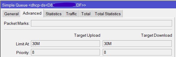

Also expected the MIN Rate Limit to become the Limit-AT in the queue
But no … this is not what I thought was logical, the (Max) Rate limit is also used as the Min Rate Limit
 name="dhcp-ds<D8:xx:xx:xx:xx:DF>" target=192.168.212.201/32 parent=none packet-marks="" priority=8/8 queue=default-small/default-small limit-at=30M/30M max-limit=30M/30M
      burst-limit=300M/300M burst-threshold=20M/20M burst-time=1m/1m bucket-size=0.1/0.1

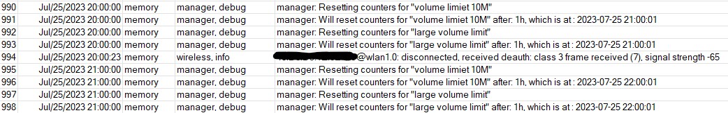

Done some more experiments, as we have many visitors now who are using Netflix (how do they do it? at 40Mbps , consuming 15GB/hour, must be running 20 hours/day. as they use 300GB per day Consuming all our “fair use” monthly volume limit in just 3 days each. And there are 20 of them, with 4 addicted Netflixers, this is not maintainable.
So started using some volume limits. But user manager kicks users completely out and denies access, when the profile-limit is used up.
Aagh, learned that the trick is to give multiple user-profile lines to every user in User Manager. A fast one with normal volume limits , and one with unlimited volume, but slow.
See https://www.youtube.com/watch?v=GxNnQtN6fu8
And then my implementation:
Using the Hotspot to give the user at least some feedback. (Only gives user total volumes, not the profile volumes, or the profile quota.)
