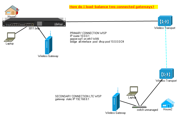

How can you load-balance between a pppoe gateway and a static gateway on the bridge?
I would like to make load balacing between the pppoe gateway on the rb3011 and a LTE gateway with static ip that resides on a trunk of the lan connected in wifi . Someone can explain to me if you can do it.
Currently in the second house I take advantage of the two gateways by configuring the routes directly on the laptop; in the first house I can’t.
I did as the manual says, but maybe I am wrong:
#pppoe-out1 on eth1
#ether5 interface connected wifi to house2 (I can ping on the gateway 192.168.8.1)

I do not have routers on the second home is all a single lan , in the second home I added a LTE gateway that provides only a static ip.
In the second house, I can use both gateways with my laptop (win7)because I added the routes and gateways manually.
From the laptop of my first home I can’t ping to the gatewayLTE.
Sorry, I’ve missed that. So actually the only interface of the router in house 1 which hosts the 192.168.8.0/24 subnet is ether5, and when you connect a laptop to that router, the laptop gets its IP address from some other subnet associated to bridge, right? And when the laptop is connected in house1, those routes on it which it uses for load balancing when connected in house2 (I still don’t know how that should be working unless it is a linux laptop) are replaced by a default route to Mikrotik’s IP address associated to bridge1?
If the above is correct, what exactly does not work?
  • There are two computers; one laptop in house 1 and another laptop in house 2.
  • From the laptop in the house 1 the ping test on the gateway LTE 192.168.8.1 does not work even if I assigned static ip.
    If I do the ping test directly from the RB3011 on the LTE gateway it works instead.
  • The problem is that I would like to combine the two gateways to achieve load balancing and failover without using static routes on laptops.

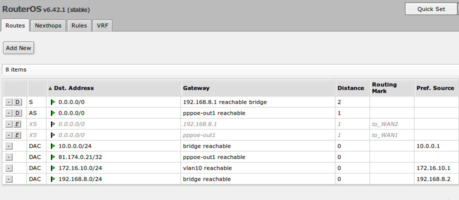

I tried the changes but can’t get them to work at this point I’d be happy with a simple failover. Now my LAN is configured as originally without any PCC rules has a pppoe gateway, and a dhcp server managed by the RB3011 . In the second house there is always the gateway with only the static ip and the access to the whole LAN works normally.
I tried doing so:
/ip route add gateway=10.0.0.1 check-gateway=ping
/ip route add gateway=192.168.8.1 distance=2
but there is something in the firewall that prevents you from reaching the LTE gateway. :frowning:
Where exactly in the second house? On the laptop which lives there? I suppose that if its gateway is the 192.168.8.1, it uses the LTE box, and if the gateway is 192.168.8.2, it uses the PPPoE via the Mikrotik
This way, the route with distance=2 is only used if the other one (with default value of distance which is 1) is down; it can happen that the gateway of the higher priority route is pingable but you cannot get anywhere further through it so it is not a good approach. Plus, in your case, 10.0.0.1 is in the LAN subnet, so it cannot be a gateway; a gateway must be either the pppoe-out1 itself as an interface or, better if possible, the remote address indicated by the PPPoE server because in such case you can use the recursive next-hop search to track the link state all the way to the Internet.

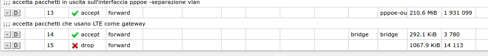

But to the topics, when you look at the rules in chain=forward of the /ip firewall filter, the last two explain why it doesn’t work:
add action=accept chain=forward comment=“accetta pacchetti in uscita sull’interfaccia pppoe -separazione vlan” out-interface=pppoe-out1
add action=drop chain=forward
All the rules before those two accept only packets belonging to already established connections and those coming in/out via ipsec tunnels, so any new connections can only establish via pppoe-out1.
So a rule accepting also packets with out-interface=bridge inserted before the action=drop one should be enough to make it possible to use the LTE as another uplink, so the result would be
add action=accept chain=forward comment=“accetta pacchetti che usano LTE come gateway” out-interface=bridge
