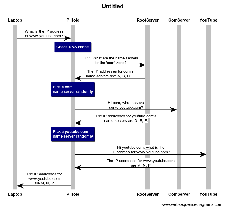

Unbound is the name of the software your servers run, not the name of servers that they query. Your unbound servers don’t have the entire world’s database of IP/name mappings installed. If they are actually able to resolve names to IP addresses, they are definitely querying outside servers. They might not be querying the recursive resolvers that your ISP assigns to you, but they are definitely querying SOMEBODY. Here is a super primitive diagram that kinda shows what happens (a) when your laptop needs to know the IP address of www.youtube.com, (b) it asks your PiHole, and (c) the PiHole has nothing cached, so it has to query everything, and (d) everything works normally as expected. In reality it’s much more complicated, but this gets the idea across.
Now, most people don’t have a PiHole, so if you’re reading this and wondering how it works in YOUR network, since you don’t have a PiHole, just change the label from “PiHole” to something else. It might be “Mikrotik Router” in the ‘PiHole’ column, if your router does DNS resolution for your network. Or it might be “My ISP’s DNS server” instead of “PiHole” if you use the DNS server your ISP assigns. Something, somewhere in your network, acts as a “recursive resolver” to do all the chasing of records I showed in that diagram.

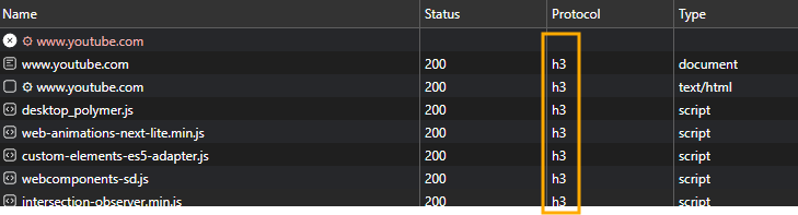

Your info are outdated. Look at this Protocol column when loading the front page of YouTube (and see document/text/html on the Type column beside it).
Now, do you know what transport layer HTTP/3 relies on?
