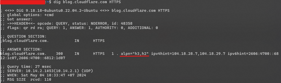

If a site supports both HTTP/2 and HTTP/3, even if you successfully identify and block the HTTP/2 connection to it, eventually the users will still be able to access the sites. Because nowadays, to profit from the latency advantages that HTTP/3 brings immediately, even when visiting a brand-new site, browsers will try to establish both connections, TCP for HTTP/2 and QUIC for HTTP/3 at the same time. And if HTTP/3 “wins” (because of lower latency) the browsers will switch to using it immediately and don’t even wait for the HTTP/2 connection to complete. Here you can see my browser (Edge) says that it switches to using HTTP/3 because it won the race when I tried to access medium.com
Also, last November RFC 9460 has became “Proposed Standard”. With this (HTTPS Resource Record in DNS) sites are now able to instruct browsers to always use HTTP/3, there is no need to initiate the parallel HTTP/2 connection. Modern browsers currently already query for RR type 65 (HTTPS RR) when looking up the domain with DNS, and CDN like Cloudflare already enable the records when the hosted site support HTTP/3. Here you can see apln=“h3,h2” in the HTTPS record as an example.
