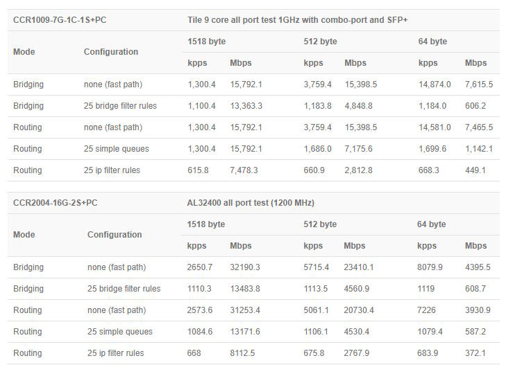

comparison of both passive devices performance looks very simmilar, not an upgrade in some scenarios but enough if you need a replacement

Well I wouldn’t bring overclocking argument to the table at all if CCR2004-PC provided higher base performance out of the box than CCR1009-PC at 1200mhz in the first place. Basically my point is that with fairly basic config CCR1009-PC is faster (marginally but still) device than CCR2004-PC that is supposed to be its successor. So it’d be rational to expect it to be just plain faster. Period. It’s just not sane thing to assume that successor of device model will perform worse. It didn’t even come across my mind that such situation could exist in real world.
That said I checked pricing of CCR1009-7G-1C-1S+PC back in the day, corrected it by inflation and compared to CCR2004, coming to conclusion that in matter of fact CCR2004-PC is realistically almost 50% cheaper than CCR1009-PC was at the time (considering value of money) so… idk. I guess I can’t complain as much as I thought I can…
I know, I was comparing benchmark results not clock-to-clock. I was comparing CCR1009-RM benchmark results - which has 1200 mhz ootb because you can set CCR1009-PC to 1200mhz as well. That’s why I used that table for comparison to CCR2004-PC. So I basically compared best case CCR1009-PC to best case CCR2004-PC. And in such case CCR1009-PC is (at least according to benchmarks) faster device than CCR2004-PC.

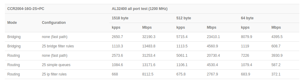

Well yes. Maybe indeed I just got a little bit misguided by claim of “Up to 300% faster than the previous CCR1009 routers” without adding “And up to 57% slower than the previous CCR1009 routers”

Okay so I’m back.
Yes it did. And in fact for my use case difference between 12S+ variant fall as low as 8% which while still makes me a little bit salty, is still considerable improvement from claimed 15% drop indicated by benchmarks on website. That was TL;DR version, now into details:
