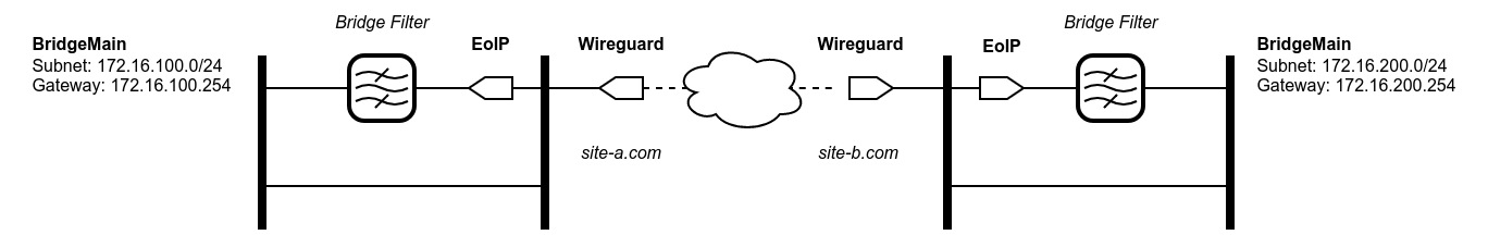

This is a guide for getting mDNS (Bonjour) and SSDP (for DLNA) working across a Wireguard interface linking two Mikrotik routers running ROS7.7 or greater without needing fluff like IGMP Proxy/PIM/Avahi/Containers.
The attachment below shows the implementation. Bold above the flag symbol indicates actual interfaces. The heavy vertical lines are a shared network layer.
The routers’ bridges are not using VLAN-filtering as it’s usually not necessary in this case for home routers.

Bridge Filtering
At this stage both bridges are linked in the broadcast domain which will be a disaster if left unfiltered. Any broadcasts including DHCP requests and replies will flow both ways.
We just want to let mDNS and SSDP broadcasts through and absolutely nothing else and this can be done by using the Bridge Filter - I think a powerful feature of ROS usually forgotten lying in a dusty corner.
