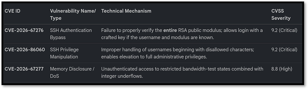

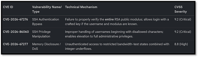

Updated research from previous post. Restricted to two links, but included the references.
BLUF: Multiple CVEs, tracked as “MikroTrick,” are actively being exploited reported as early as the start of September. MikroTrick takes advantage of an SSH bypass, compromising an initial user, to then leverage SSH privilege manipulation resulting in administrative access. Unauthenticated Denial of Service (DoS) can also be performed from the bandwidth-test server.
Timeline:
Figure 1: CVEs chained for “MikroTrick”
Detections:
Remediations:
Resources:
