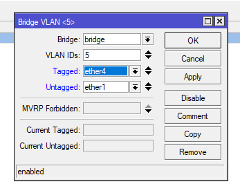

- or you can create a WAN VLAN on the bridge on the 2011, add ether1 as an access port to that VLAN, and add that VLAN in trunk mode to the port to which the hypervisor is connected, if your hypervisor allows tagged frames and can deliver them tagged or tagless to the VMs
Yes, but it is not enough. You also have to set pvid=5 on the /interface/bridge/port row for ether1. You can leave the untagged list empty in the above window because ether1 will be added to it automatically as you do the previous step, but you must add also the bridge to the tagged list for VLAN 5 - see here why. To make these settings actually work, you have to set vlan-filtering on the bridge to yes. And finally you have to attach an /interface/vlan to the bridge and move the ..210.41/24 from ether1 to this /interface/vlan.
210.42 not 210.41?
Sorry, 210.54, no idea how I confused it for 210.42. In the routing case, you do not touch the 210.41 at all; in the bridging case, you move it from ether1 to vlan 5 interface on bridge.
