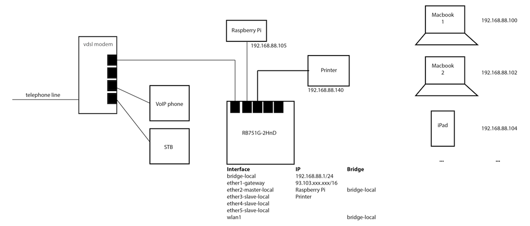

I’d like to solve a simple problem of having an IPTV access on my wireless devices at home.
I’ve tried using IGMP-proxy, but it doesn’t work well with wireless solutions - each time I open an UDP broadcast connection, whole network slows down.
Since I’ve got a spare Raspberry Pi, I thought I’d use it with udpxy server. I’d like to use the udpxy program (running on raspberry) to forward me IPTV streams via HTTP upon request.
I’m not really sure how to configure the router for such scenario, so I hope anyone here could help me? I’ve attached my network schematics.
What I’d like to achieve is, enable my Raspberry to have access to broadcast UDP traffic (e.g.: 239.1.1.115:5000) which is available on the gateway interface, without IGMP-proxy disturbing my WLAN traffic (since it goes berserk, if anyone is accessing broadcast IPs), and serve me on my local network (192.168.88.1/24).
Any help would be much appreciated.

I am looking at your diagram again.
Does the modem (which is presumably a router too) send multicast traffic out of all ports regardless? If it does then you may be seeing multicast traffic created when the STB requests a channel.
The routerboard is apparently birdging all interfaces so the WiFi interface will see multicast traffic any time that the routerboard receives such traffic from the VDSL modem/router. FYI - you can go in to the WiFi interface and tell it not to forward multicast traffic even though the bridge may be seeing multicast traffic.
I’m not sure … I wouldn’t say, since the light blink independently. What I know is, all ports act the same on the modem. It doesn’t matter, where I plug the VoIP phone, STB or router. And I also know, that I can have more than one STB.
STB doesn’t affect traffic on the routerboard.

Isn’t it feasible to use the router to do routing instead of bridging?
Set 1 input port from the modem, 1 output to the Raspberry allowing forwarding of multicast traffic, and the printer and WiFi in bridge mode to serve the local network, with multicast blocked.
I am not familiar with the 751g, but i think that i can do some pretty data flow in router mode.

Raspberry only has one nic. If it had two, I’d connect one directly to modem, and the other one to routerboard. Then set the udpxy to listen on the IP from the second nic (192.168.88.105).
Is there any other way to do this? I had virtual ethernet interfaces in mind, but I cannot make a software bridge on the Raspberry (since it’s not included in the raspberry’s debian kernel).

This is not what I suggested…
Connect devices exactly as in the picture.
  • Get the traffic from the vdsl into first interface (lets say eth0) of the RB751
  • On the second interface (eth1) connect the Raspberry
  • Forward multicast data between interfaces eth0 and eth1 and block multicast to the other interfaces
  • allow forward of unicast traffic between all other interfaces.
Or even simpler:
  • bridge first and second port
  • bridge the other ports
  • drop multicast traffic between the 2 bridges and allow only unicast (using forward rules).
In this way, you will get multicast traffic only between vdsl and Raspberry, and not on the WLAN.
You have a 5 port router… Why use it as a 2 port router with a a switch :laughing: ?
Yes, you do have a point. I’ll see which solution seems more elegant.
Pure awesomeness … It works guys!
