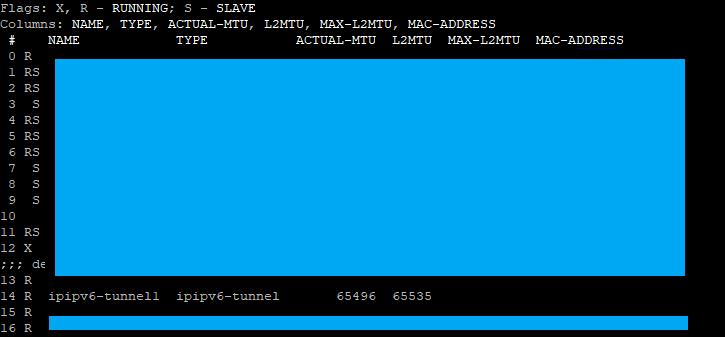

when you see a ff:fe, that means that it’s EUI64 generated from mac. Since this is a layer 3 tunnel it doesn’t appear a mac address is generated
(I checked by creating a tunnel and using /interface/print)
Though it is creating the ipv6 address based off this mac FE:FD:00:00:00:00 (if my math is correct)
Just weird
