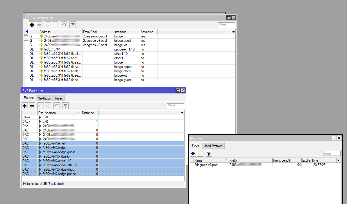

I thought I’d comment with something I’ve found with RouterOS 7.x and that is SLAAC does work but there is a bug here preventing it from working fully. On my Mikrotik RB4011 running 7.x I find it inserts garbage IPv6 routes in which when removed IPv6 actually does work - until it renews the address pool breaking IPv6 again due to the garbage routes being re-added. On RouterOS 6.48 IPv6 works as expected. Some posts suggest this may be a RB4011 specific problem but will be interesting to see if this is the behavior others are seeing as I personally don’t have another Mikrotik hanging around to test with.
