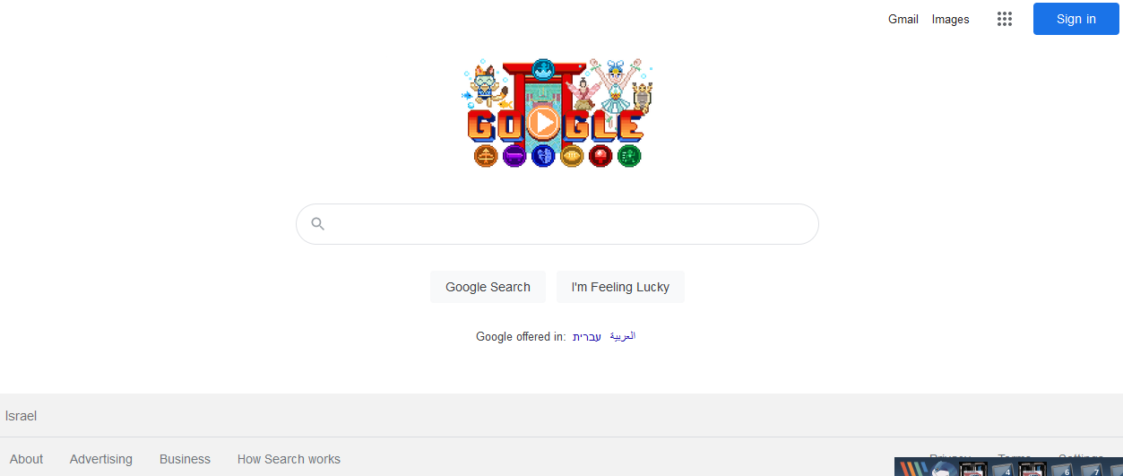

When opening browser and connected to say google.com the result (no search yet just opened google.com) page is in foreign language (the language of the country google thinks the computer is in, even though the client is actually in the same city as the CCR1009).

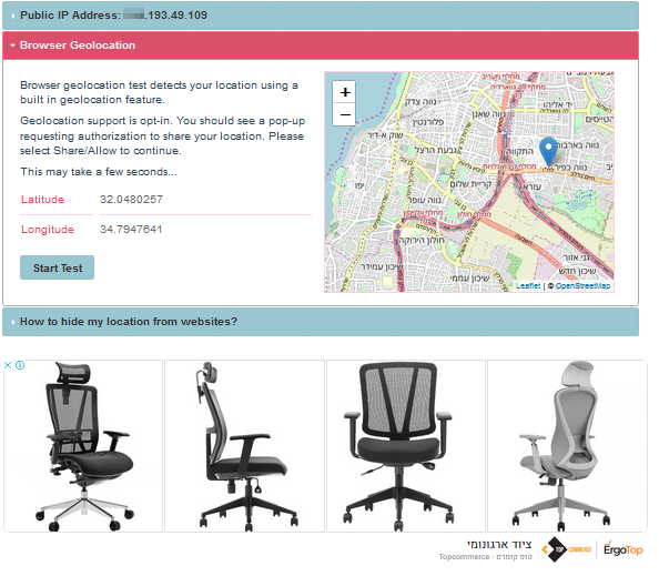

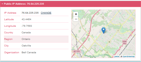

Using https://mylocation.org/
Shows the correct IP address but the browser geolocation shows the country where the computer is located.
The google ads all display based on the country the computer is located in rather than the location of IP address. This really screws up clients connected to the L2TP/IPsec VPN on the CCR1009.

The browser geolocation is actually correct, but that’s not the desired result. It should show the country where the IP address is. In this case the IP address is located in Canada. The map image above is not Canada.
Thanks.

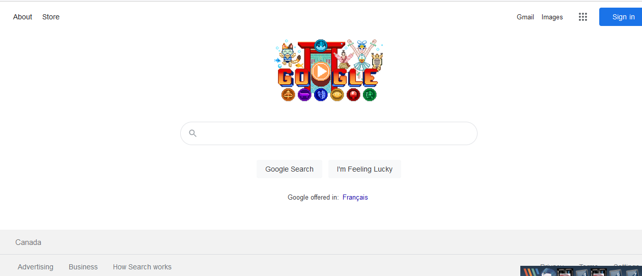

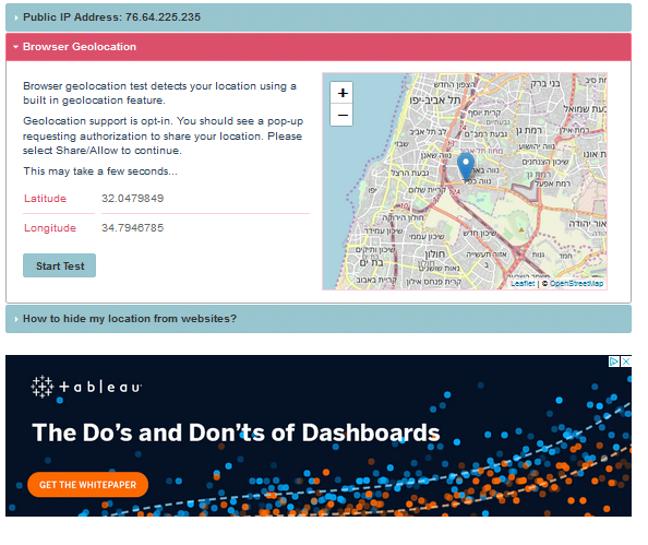

Connected now to hEX S L2TP/IPsec vpn, IP address is right but same issue it seems with browser geolocation. The google ad at the bottom though is not in foreign language.
But when going to google.com it sees me in Canada with hEX S
Disconnect from hEX S and connect to CCR1009 and then open google.com
What the heck is causing this???
