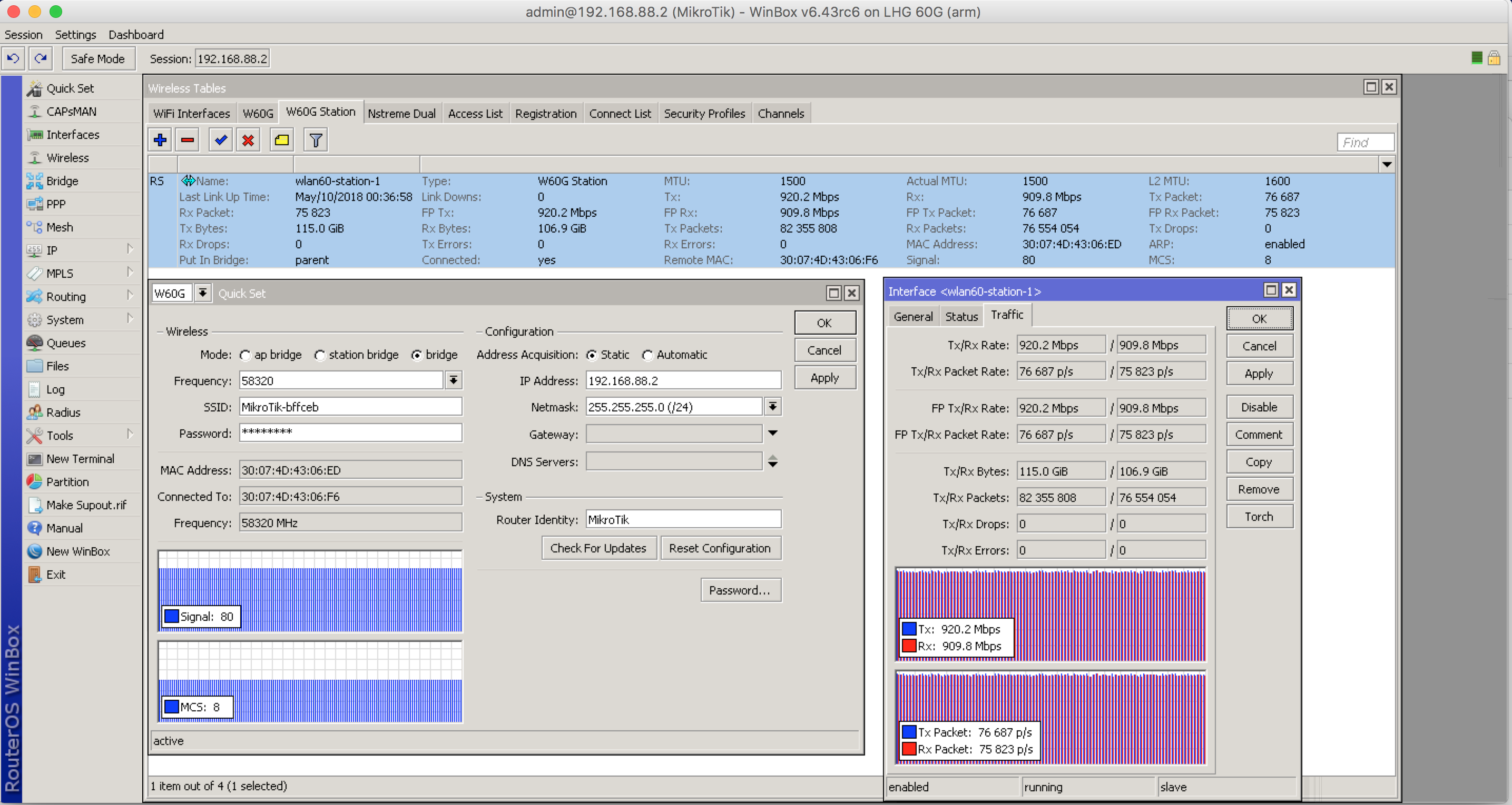

A customer from Hawaii has gotten his first LHG60 link up with good results. Here are some photos and test results:
1,470 Meter Link

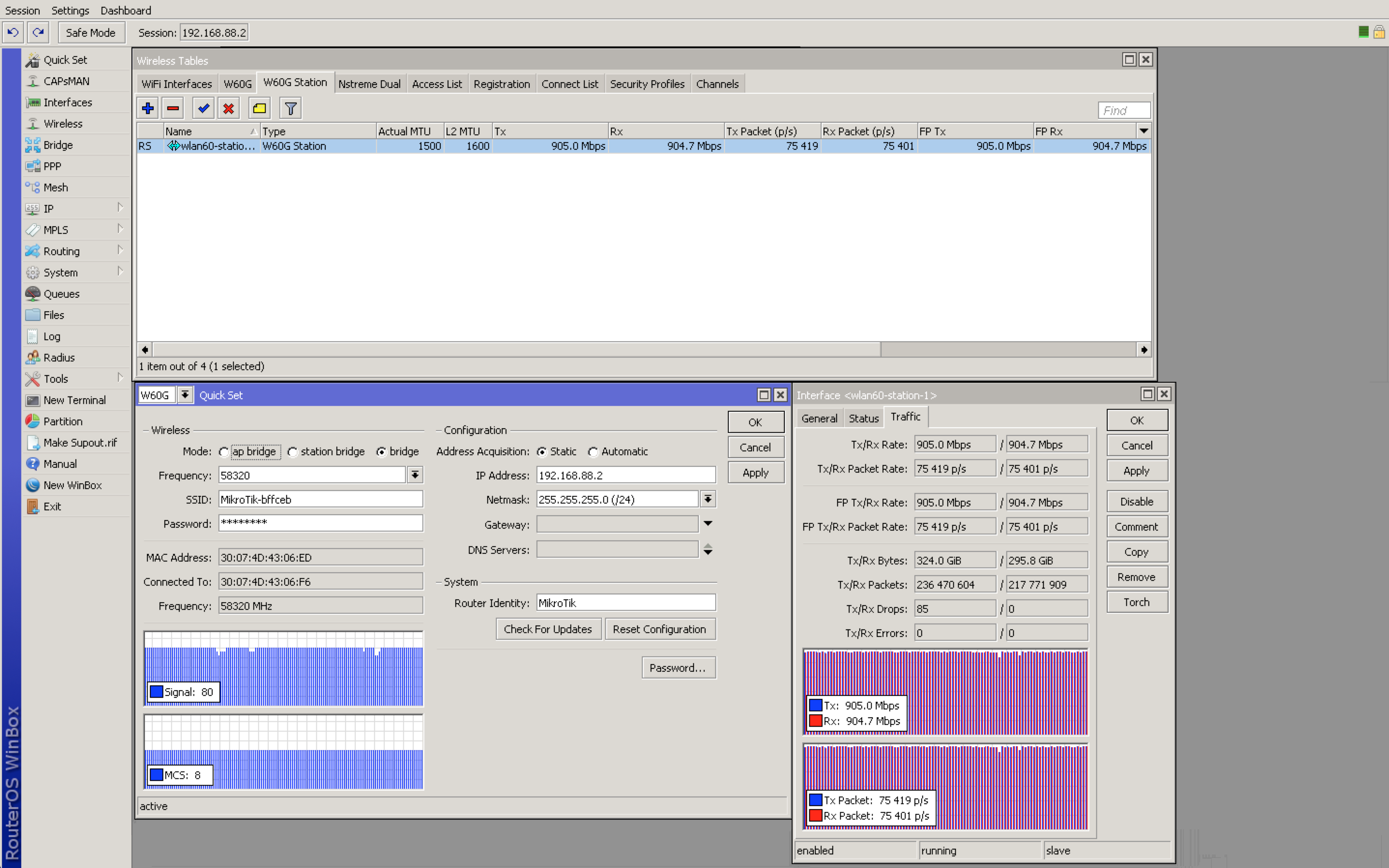

TRAFFIC GENERATOR TEST SETUP:
LHGG60 in Bridge Mode (192.168.88.2) - - to - - LHGG60 in Station Bridge Mode (192.168.88.3)
MacBook Pro (192.168.88.10)
/tool traffic-generator packet-template
add ip-dst=192.168.88.2 ip-gateway=192.168.88.3 ip-src=192.168.88.10
name=test1 udp-dst-port=100-300
/tool traffic-generator stream
add mbps=2000 name=stream3 packet-size=1500 tx-template=test1
