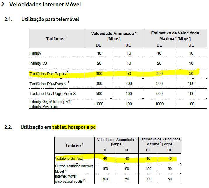

Some network operators limit the bandwidth when they detect that the SIM card is installed on a PC/tablets or router. They give full bandwidth only if the SIM card is installed in a phone. (They can differentiate both with the modem IMEI)
That would explain why you have better performances with your phone.
For instance, Vodafone Portugal limits the bandwidth for pre-paid card installed on PC/tablets/routers to 40Mbit/s DL/UL, but allow full speed if installed on phones.
The above statement is true. Particularly, when the mobile operator provides unlimited data, they introduce restrictions such as the above.
