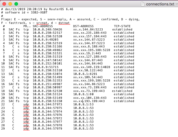

You can do:
/ip firewall connection print file=connections.txt
And if you wrap it in a script run from scheduler that would generate unique file names like connections-2019-12-11-18-23-00.txt, you could use it to keep history. But working with all those files will be probably nightmare.

Okay Sob, this seems promising despite the potential file nightmare…it might be several days before I can attempt…thank you!

Okay Sob your suggestion worked…see images…and I were able to print to disk. So now the task is to improve the script to get it to do what I wanted. I read up on scripting and it appears to me who have never scripted on Mikrotik that it can get very complex easily.
I never found RouterOS scripting intuitive, so personally I wouldn’t go there. The only scripting I’d do would be making unique file names, so that multiple files could be saved. Then I’d download them and do needed processing elsewhere using other means.
That’s if I’d choose this way with snapshots of connections table. But truth is, it feels too much as reinventing the wheel, additionally with a prospect that result could be sort of ok, but not great. If you want better long term solution, look for something that already exists and is made for this.

Snapshots…that’s what I have been thinking now…something like random snapshots since it’s for a home office. You’re correct on the feeling that its sort of reinventing the wheel.
