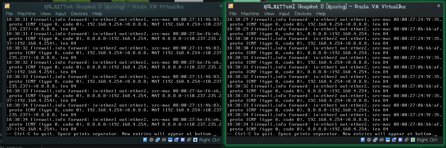

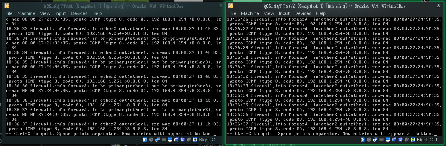

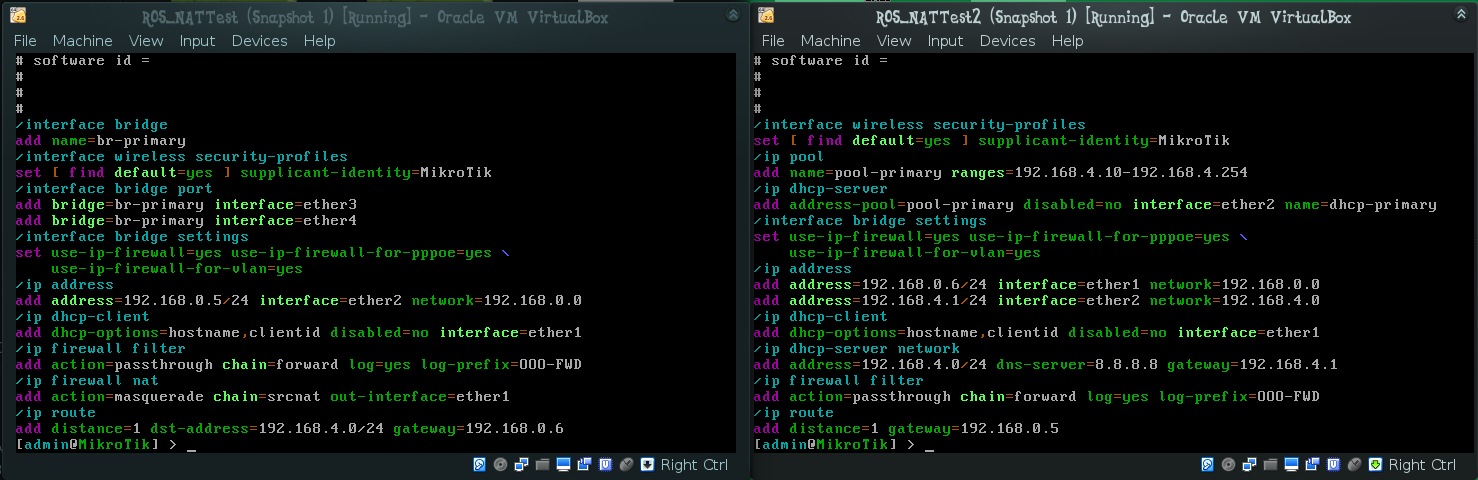

Unfortunately it doesn’t work because RB2011 doesn’t perform masquerade on outgoing traffic. As configuration of actual routers is really complex and it wouldn’t make much sense to post here, I re-created issue in virtualized CHR lab:
First case (that doesn’t work) goes like this:
And ping result is follwing:
As you can see from logs masquerade is not performed properly. Second case (that works) goes like this:
Config is the same. As you can see, now as machine is connected directly to second router so that packets are going through router1 only once, masquerade is performed properly (src IP change visible in log). When I enabled more detailed logging in actual setup I noticed that all chains except srcnat and dstnat are entered on every packet, but srcnat and dstnat are entered only once, at the beginning of connection, when packets go through br-primary. Of course it’s too early to perform masquerade now so in the end masquerade doesn’t work. Here’s log from actual RB2011:

It must be bridge’s use-ip-firewall=yes. I don’t think I’ve ever seriously used it, so I wasn’t sure if it’s:
a) Just the same filtering mechanism, but independent from routing, i.e. router would see connection on bridge as one, then as another when it comes back from the other router.
b) It’s connected and router sees both as same connection.
As you proved, it’s b) and then the result makes sense. Try to find a way how to do what you want without use-ip-firewall=yes, bridge filtering might be good enough, but it depends on what exactly you need.
