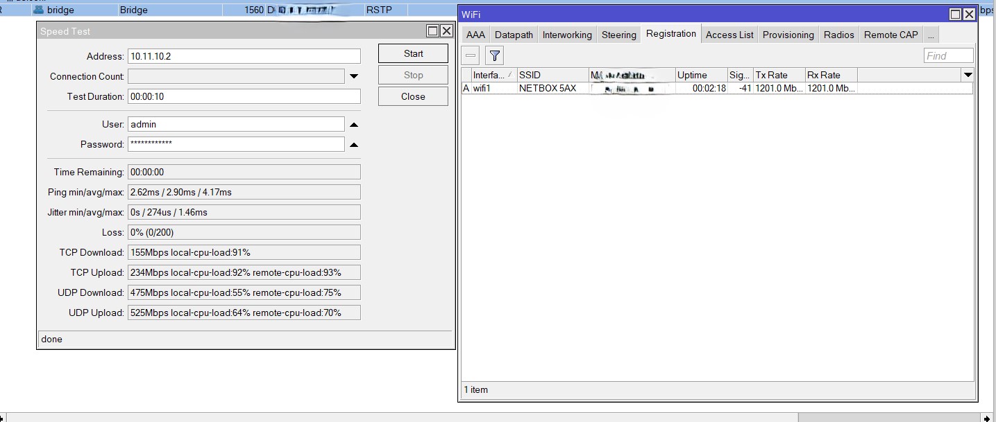

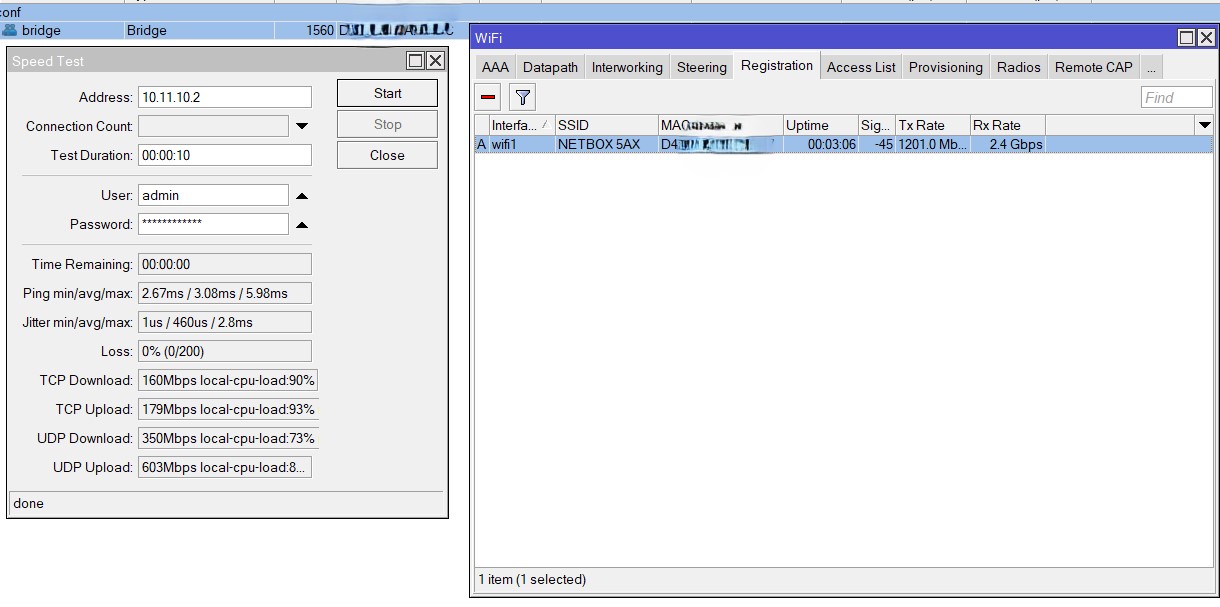

I am experiencing low bandwidth issue with my MikroTik NetBox5 AX pair, which is paired with MANT30 antennas. Despite using 80 MHz and 160 MHz channel widths, I am only achieving bandwidths of 400 to 450 Mbps on 80mhz and 400 Mbps on 160mhz, respectively, within a single room. This performance is significantly lower than expected for these configurations.
Here are the details of my setup:
Device Model: NetBox5 AX (Pair)
Antenna Model: MANT30
Channel Width: 80 MHz and 160 MHz
Observed Bandwidth: 400-450 Mbps on 80 MHz, 400 Mbps on 160 MHz
Environment: Single room with minimal physical obstructions
Could anyone please provide guidance on troubleshooting this issue? I have already verified the following:
Firmware is up-to-date 7.15.3 stable.
Channel settings are optimized and not overlapping with other devices.
Devices and antennas are within a close range of each other with minimal interference.
hear is config of ap
Can you post your config export?
Be sure you have your Country / Region set. What 5Ghz Frequency are you using? I believe 5220 is MikroTik “sweet spot”. Lastly, since newer 7.13? release – you have to manually configure distance value.
At what signal strength do the points see each other?
Most likely the problem is in incorrect experimental conditions
finaly romoved netbox5 ax and installed mimosa C5c devices now stable signal -59 distance is 25km and bandwidth is around 500 mbps.
