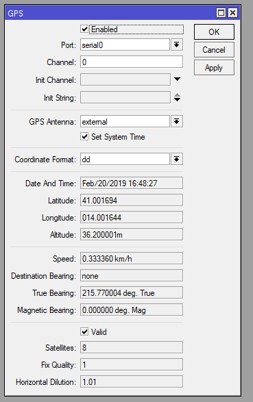

Hi, does someone know how to solve the problem of the 00 in the latitude and longitude reading of router OS ? I have this problem on Router OS v.6.44rc1 when i set gps format do DD.
The tracking works well, but with wrong coordinates value device location is not correct. Any idea to get this issue solved ?
here is a screenshot

I’m glad I am not the only one to discover the extra 00 in the coordinates bug when coordinates format is set to dd
To clarify for anyone who has pull to get this fixed-
There are two extra 0s prepended to the portion of the coordinates to the right of the decimal place. This occurs for both latitude and longitude.
Example: If you are located at 40.123456, -120.789123, the device reports your coordinates as 40.001234, -120.007891.
The issue has been fixed with the additional “\00” values at the end of the output and will be released on all three branches with the next releases.
This should be fixed too, if you still encounter the issue, please write an e-mail to support@mikrotik.com providing Supout.rif file of your device generated when you experience the issue.
