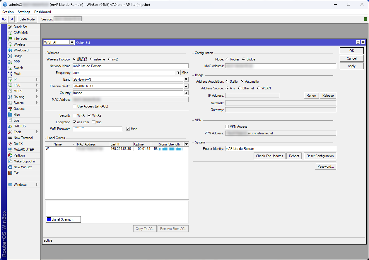

Hi!
It was actually quite obvious: I’ve just used Quick Set in WISP Mode, then chose the Bridge instead of the Router Configuration.
The rest is up to you.
With this config, as the name suggests, the mAP Lite acts as a bridge.
So if you plug the mAP Lite to a device and connect a client to the SSID, you get the same result as if you had plugged a network switch between the device and the client.
So if it’s a managed network switch, you can manually configure your client with an IPv4 address in the same range as the switch (check its manual) and then connect as if you were wired.
